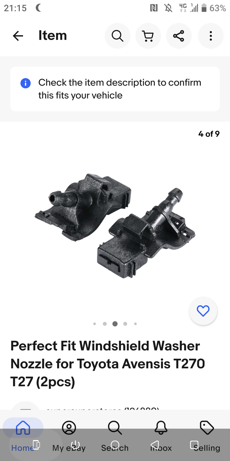

I'm not averse to buying another couple of jets, but it's the however-long-it-takes-for-them-to-get-from-China that puts me off..........
Can you find a picture of replacements? May give you a clue as to how they fit/secure.
But burnerman is probably right. Little, very brittle wings, that clip in, or else a grooved section that sits into a hole and then slides to secure

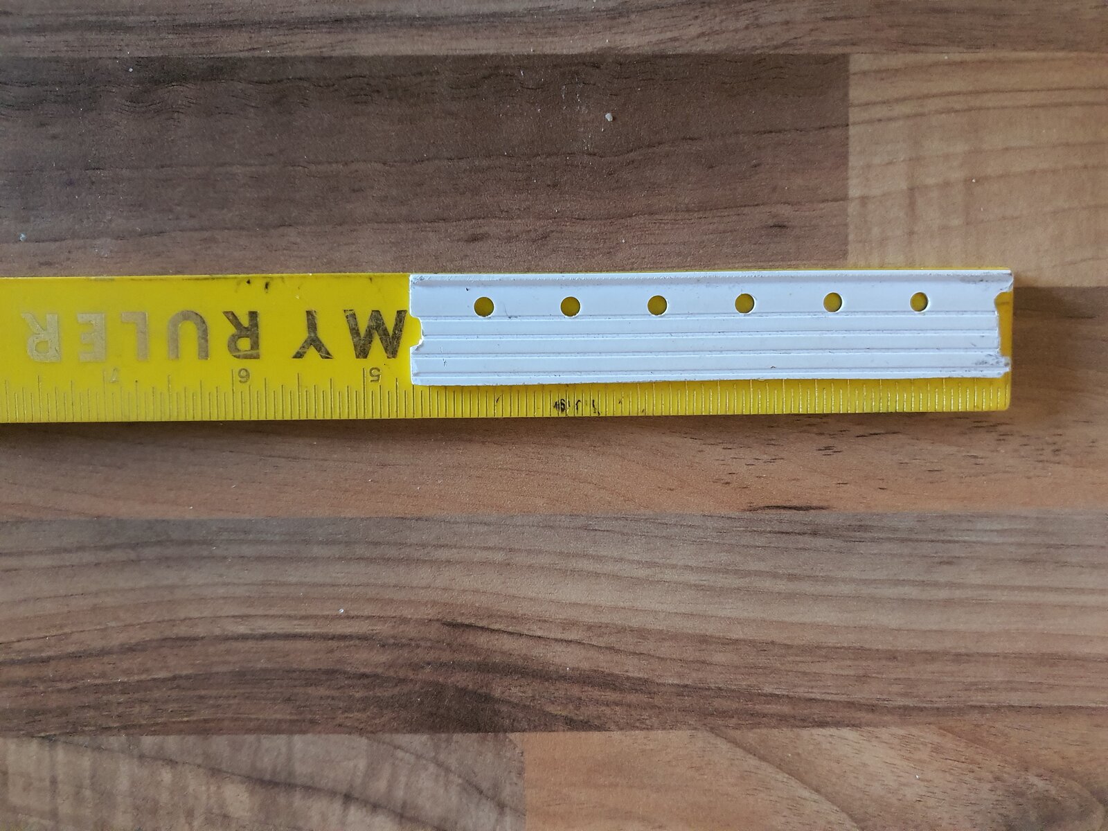

I have made a washer jet removal tool for the T25. It's in the shed, I'll try to post a picture tomorrow.
I've done that already ( looked at the pictures) but what appears to be the retaining tangs........ well, I'm fudged if I can shift them......

This is what I made to remove the washer jets on Avensis T25. It's only a piece of 2mm thick plastic trim cut to fit the underside of the jet. Just push it hard until the clip is released and remove it from the top.
Well........
....fashioned a sliver of upvc (as per @Stivino suggestion), and the jet popped out a treat (y)
(with the bonnet down, slide the "blade" between the jet and the bonnet skin, and press - towards the front of the car - a mm or two, until the jet is eased from the bonnet).
