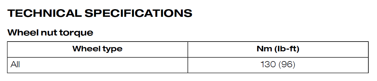

Same here. Looks to me like Ford are making a black art out of something simple. What "condition" are they referring to? Maybe the rest of the manual makes it clear. And does it refer to nuts for alloy wheels which (if they're like mine) have a cone-shaped ring free to rotate, or solid nuts with a cone end?
Just the column on the left, "seized wheels nuts"
And does it refer to nuts ... have a cone-shaped ring free to rotate
The only reference to the "conical washer" (as they call it) in the whole manual, is the differing torque. It's 130Nm for most nuts, but 110Nm for conical washer ones.
The Mk2.5 facelift manual (2008-on), not the workshop manual I was on about before, says...
Were the early models 90Nm then? When it was 4 stud M10, pre 2005.
