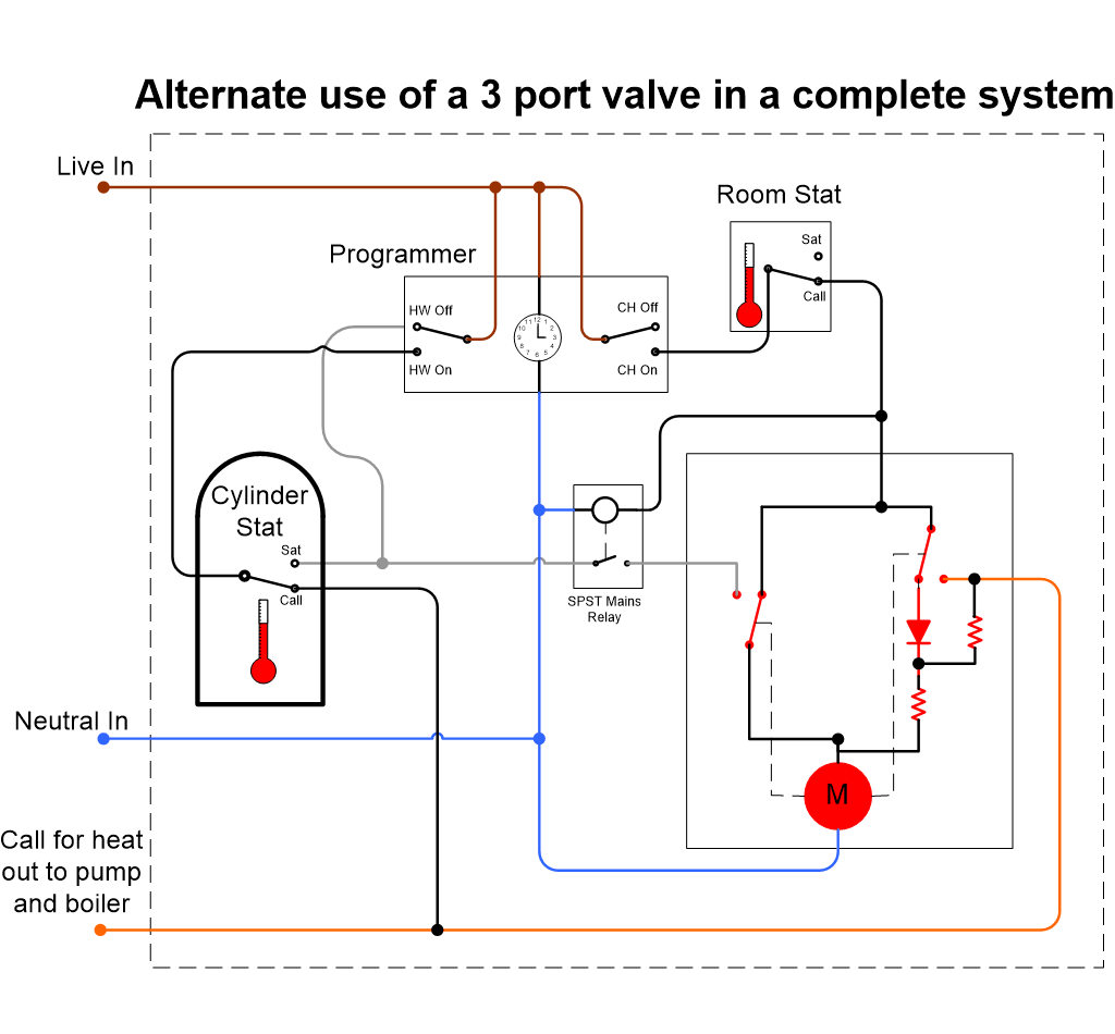

Just to confirm what I am up to:
I have a Y-Plan central heating and hot water system.
My current controller is on its way out and, as I am into home-automation, I am swapping it with one of these:
The only issue with this is that none of these devices come with SPDT switches, so (due to the way that Y-Plan is connected) I need to use a separate SDPT relay to control the hot water part.
Also, I need the SPST switch to update my Y-Plan system so that the actuator is not hold in the heating position when the boiler is not on - I know that the actuators are supposed to tolerate being held for days like this but it is a simple fix that should make it last a bit longer (I attach a diagram diagram that someone kindly added on another thread).
While that is all valid, you would be far better to dispose of the 3 port valve and use 2x 2 port valves instead. No relays required, no valves being held open for ever.
There is a small advantage with the Y Plan, it allows the boiler to cool by heating DHW as that is the default state. But although this is a marked advantage with oil boilers, with gas boilers, there is little advantage.
The main problem is to heat a boiler and pipework requires energy, so you want a large droop between switch on and switch off temperatures, this is hard to do with the Y Plan.
