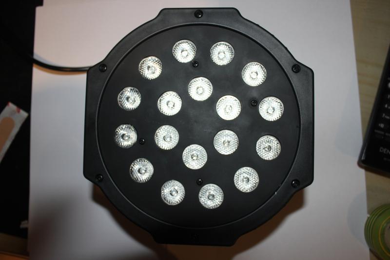

The Front of the LED Par can:

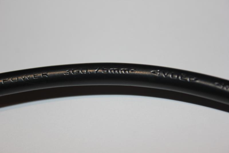

0.75mm² right?:

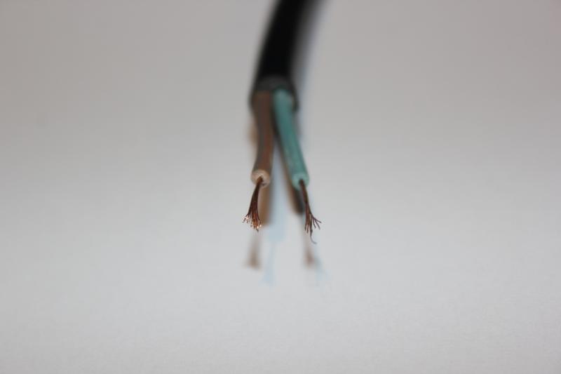

Definitely Not!:

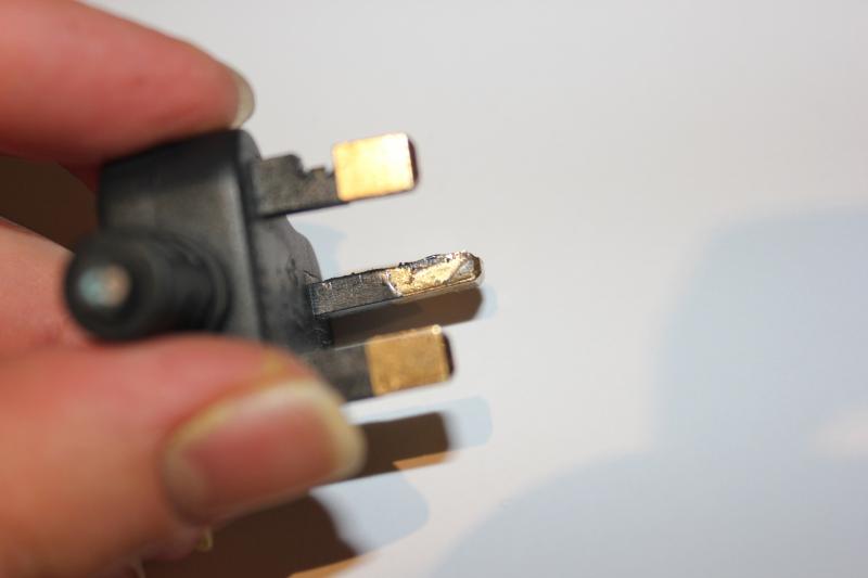

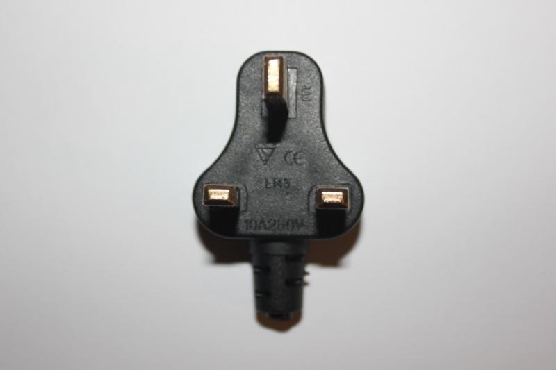

Another one of them unfused weird Chinese UK compatible plugs with half the earth pin insulated:
That earth pin appears to be not solid brass:

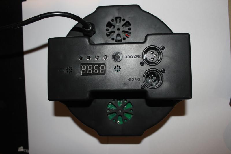

The back of the unit, spot anything dangerous:

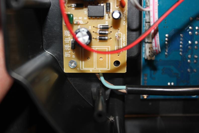

Have a closer look:
Blue as Line/Live and Brown as Neutral!? (Yes, the blue wire does go the line/live pin on the plug):

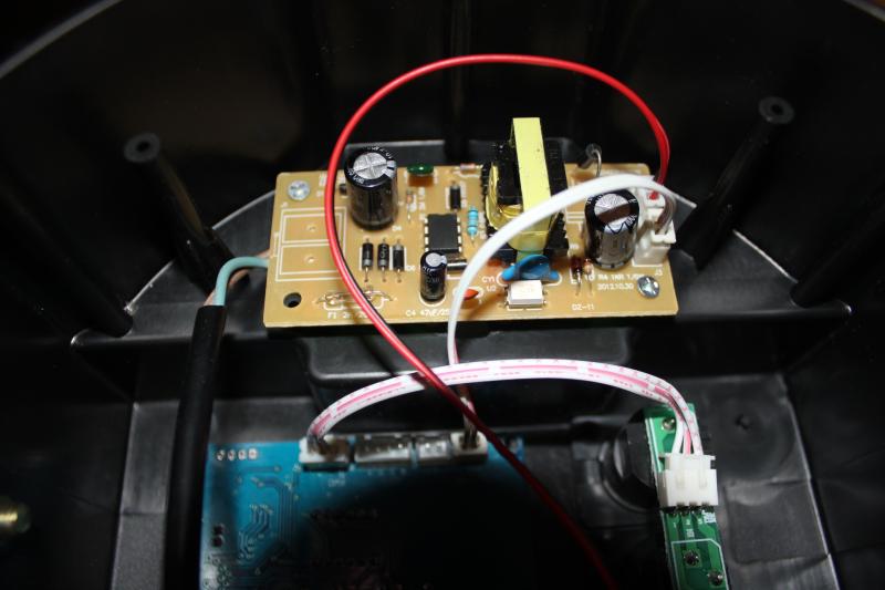

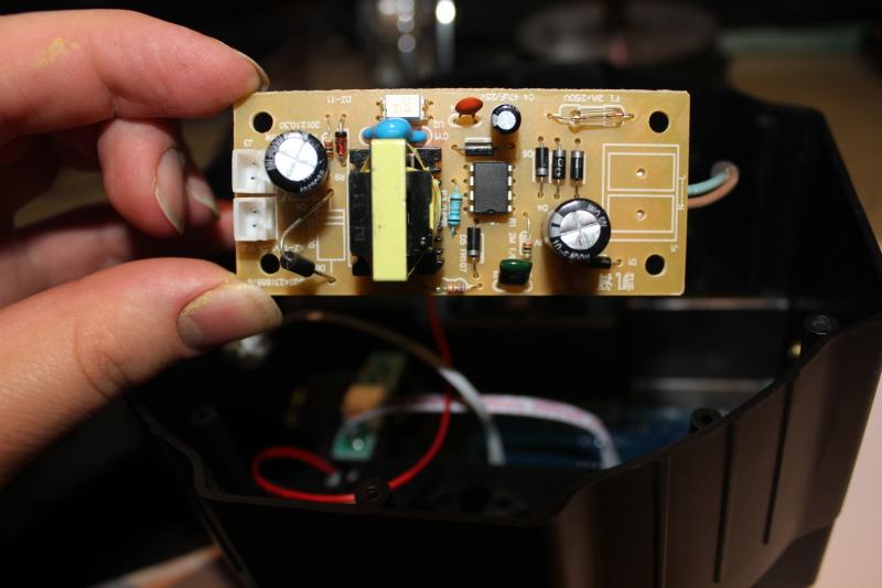

A general view inside the unit:
The front of the mains PCB:

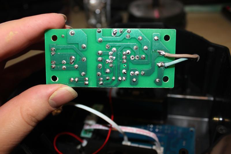

The back of the mains PCB:
