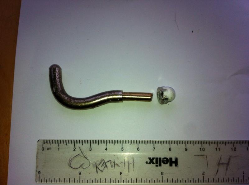

I was putting a swinging crib back together for our imminent second child and the hook snapped when I was tightening the nut (the threaded part iss in the nut in the picture). Has anyone any idea of what this type of hook is called and where I can get one? My wife is starting to panic that we won't have anywhere to put the new baby when it arrives!

This was the closest I could find, yours looks like an M8, or 8mm bolt (13mm spanner?) and you will have to put it in the vice to shape. If its a 10mm spanner, then probably a M6, or 6mm bolt.

I recently fabricated something similar to this by using a rawlbolt with an eye hook....chucking the expanding part away, obviously.
Easy enough to come by, anyway! The common or garden hooks generally seem to have a spiralled end rather than a threaded one.
