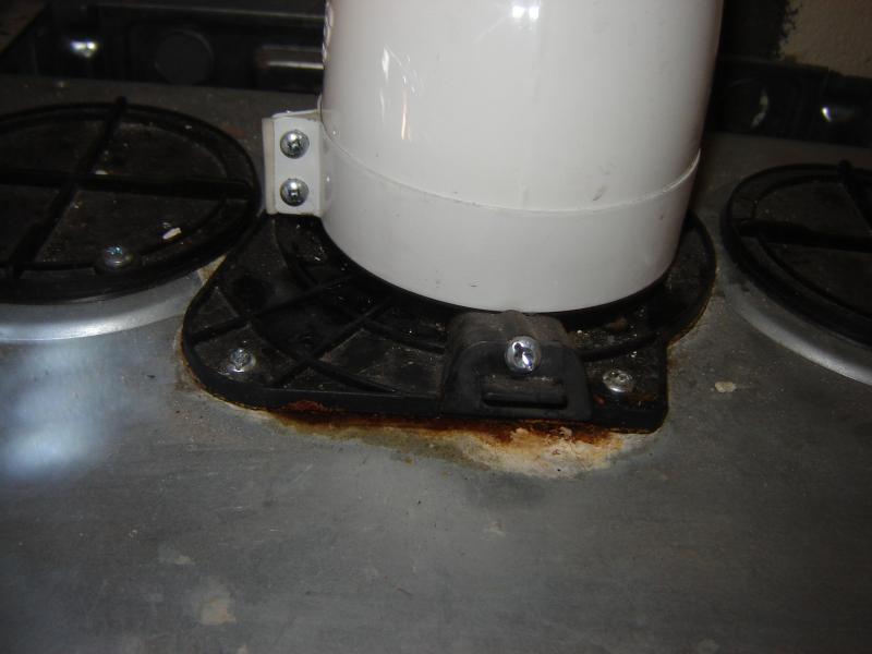

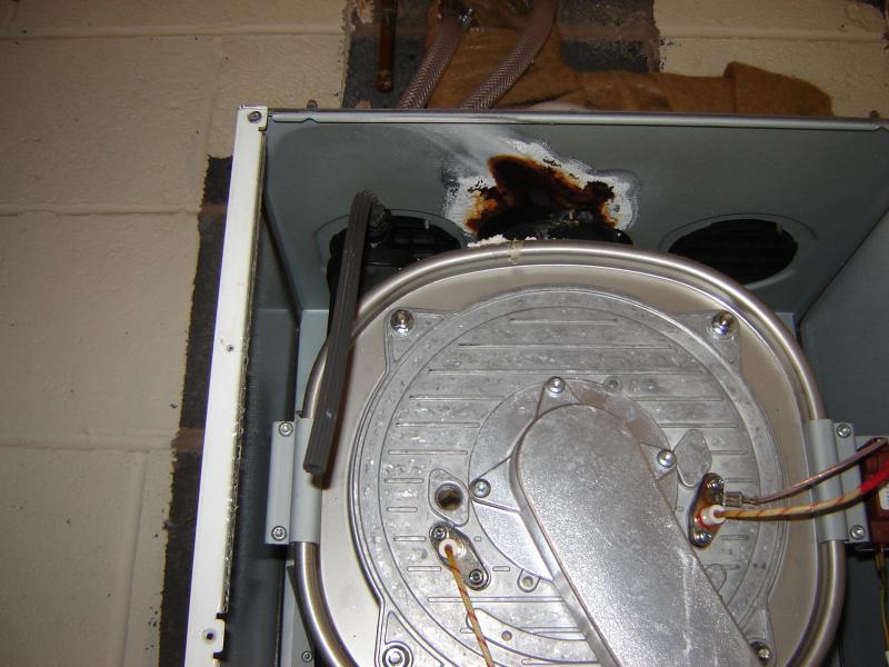

My CLAS HE 30 Ariston Boliler is one day over its 2 year guarentee. My mate whose a gas safe Plumber who didn't fit the boiler has come to service it and found that the exhaust is leaking into the boiler due to the top of the boiler being corroded where the flue is. He has given me a Warning/Advice notice. He only installs baxi and told me to get the Ariston engineer to assess the situation and he'll be there.
1. Whats the chance of me getting anything from Ariston due to this corrosion must have been happening since day one.
2. Has anyone else experienced this
Please see attached photos
For corrosion there i would say flue has not been installed properly inner duct not sealed somewhere and condensation running down outer flue duct back to boiler.
Unless top of boiler case comes seperate you would be as well getting new boiler than trying to transfer everything over into a new case IF avialable
Thanx namsag
If Its a fitting problem that the Ariston engineer identifies could I sue the installer or would it be better to go through gas safe
I wouldn't be surprised if the flue was not fitted properly in first place and the condensate has run down inside and caused the rusting, I doubt Ariston can be held responsible, they may however help/advise you (I have not had any dealings directly with them)
Having experienced Aristons "Customer relations" I wouldn't expect to get anywhere there! as has been said, this looks like an Installation fault with the flue seal etc, so go back to the original installer and see what he can do, if he is a nice guy, he might be able to help, so don't go in guns blazing! ;)
