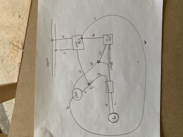

I’m adding a new shower encloser. The shower will have an all in one light and extractor fan.
I know it’s a mistake I’ve done somewhere but can’t figure out where I’m going wrong.
see my sketch of the circuit diagram.

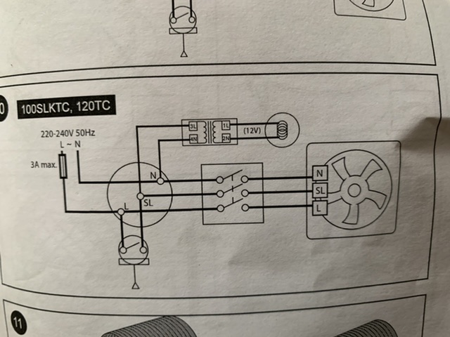

Also attached diagram of how circuit should be from fan extractor manual.

At first glance it looks like you have connected the fan L & SL to Neutral.
Is that just a drawing mistake?
Used waygo temporarily as the cable was a bit short in a couple of places. Once everything is screwed in, I can remove waygos.
But there’s two places where I needed to connect neutral from fan and light, going to fuse box.
N going into fuse box is based on the diagram / instructions that came with fuse box. The N is going in at the bottom of my sketch
The issue is light or fan is not turning on at all... even though a current is detected (using detection pen)
I’m wondering if I need a three pole isolator? I’ve just used 3 amp fused switch and a regular light switch at mo
Connections are only indicated by circles or shapes, lines overlapping aren’t connected in my sketch

No you do not need a 3 pole isolator as the FCU will isolate the fan and light - if you have wired them properly/
1. Is the fuse ok
2. Are the wagos the joining type ?
3. Check the switch to ensure screw is touching copper
You need a two probe voltage tester, or a multimeter. The magic pen will not test for the existence of the neutral connection. No neutral = no fan or light.
PS. Those magic pens don’t detect current, they detect voltage(sometimes).
The only other thing I can think of is I might have labelled the wires incorrectly, so might need to pull the wires out again and double check that.
fuse is ok, - I’ve plugged the light on it’s on directly to the fused switch, and it turned on and off.
Wagos I think are joining type, they have three clips up top.
95% sure the wires are touching, as I detached it all twice.
