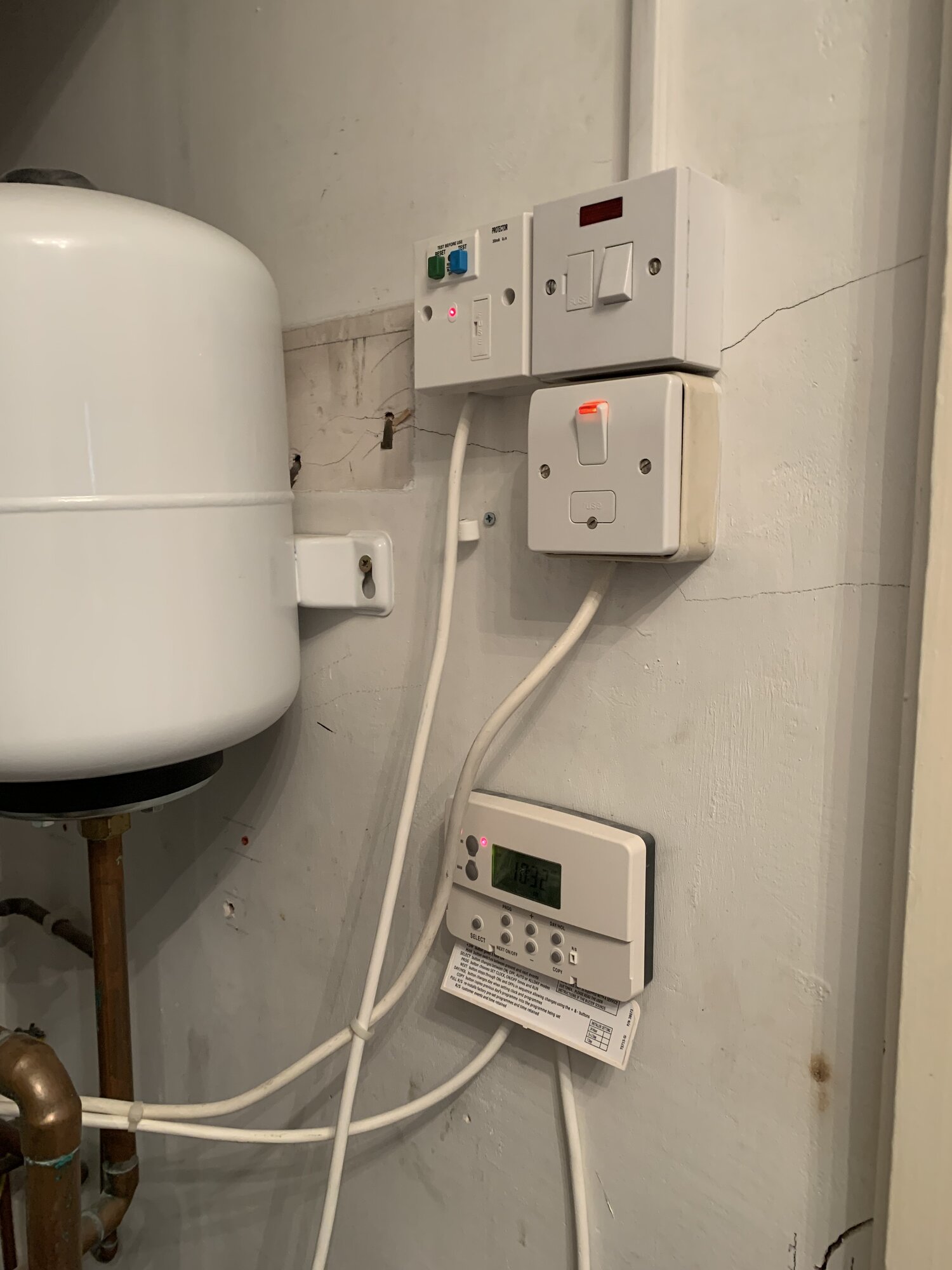

Where would a wireless thermostat receiver be..
None of it is looking very logical - might this wireless stat perhaps have nothing at all to do with the system? Might there be no stat at all, or even a wired stat on the wall somewhere?
Agree, had us a goose chase up til now :rolleyes:
It would probably be easier to find a goose then this b***y thing.....

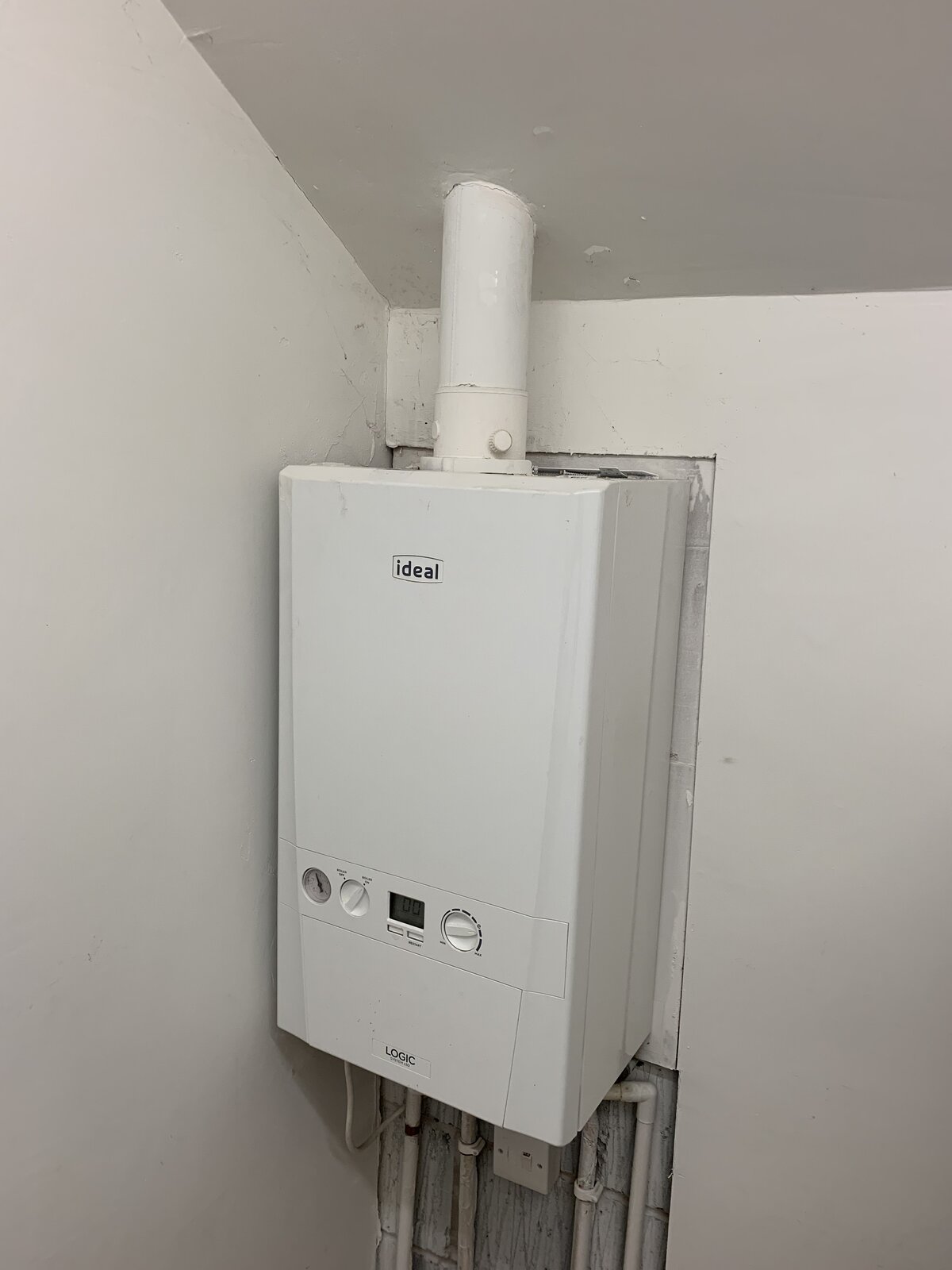

I'm not optimistic that if I get British Gas in to a system which is working (at the moment) they will have much enthusiasm for finding the receiver and will just head off to the next job...
Mmm, evenings come and the radiators are getting cold.

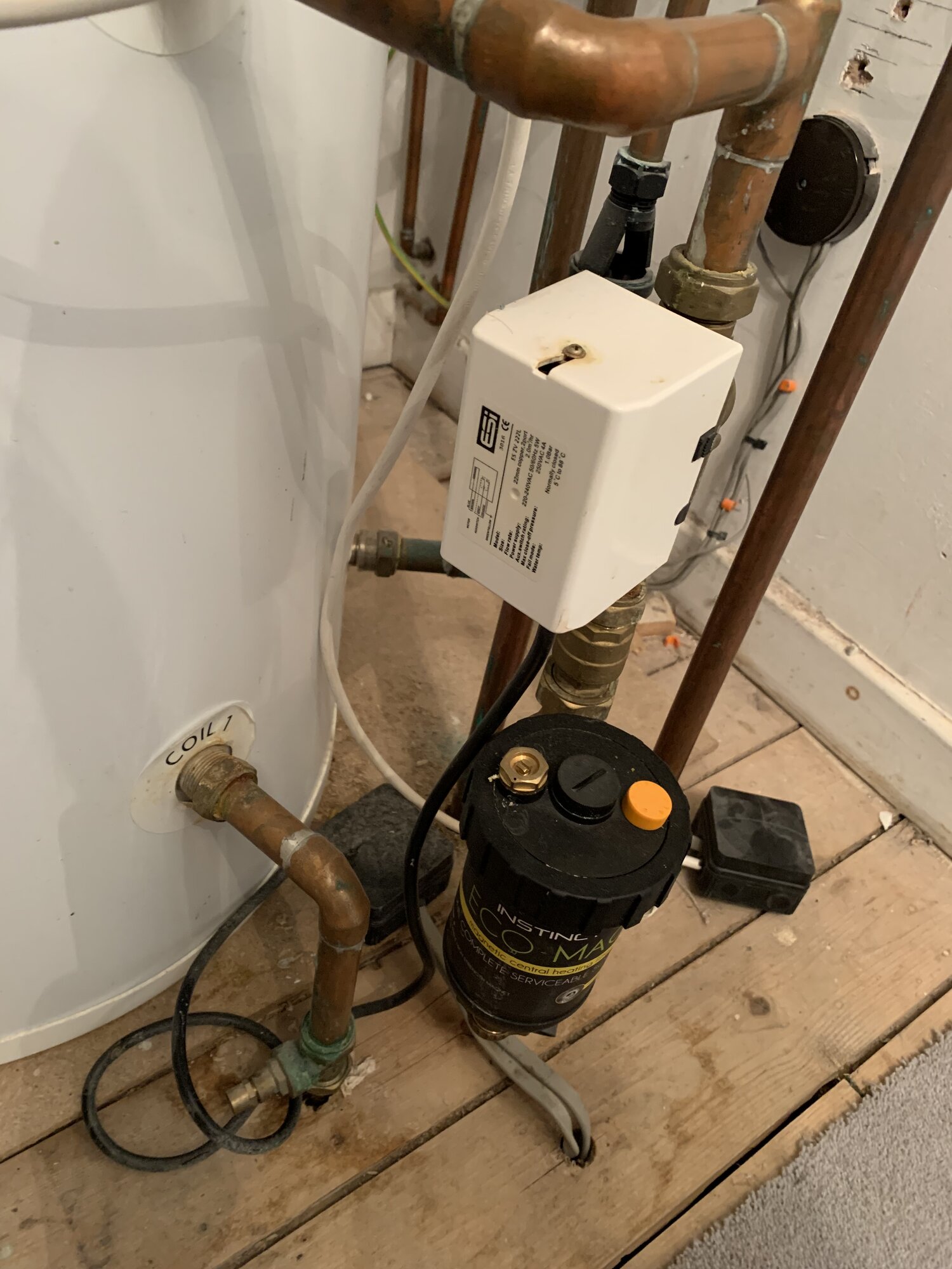

I spoke to the thermostat people and we powered down the boiler and when switching the electricity back on re-linked the stat.
Will a plumber be up for sorting out a new wireless thermostat or do I need an electrician ?
To clarify, whilst I did relink the stat it’s not working again this evening.
Difficult one - not all plumbers are electrically competent and not all electricians can cope with controls. Your are really looking for a Gas Safe guy who is familar with controls wiring.
Have you tried moving the stat closer to the area where you guess the receiver is?
Yup, tried it near the boiler and the cylinder. Will be (mildly) interesting to see if it works in the morning…
Just a thought - might the stat include a facility to show signal strength? If it does, it might help you trace the receiver.

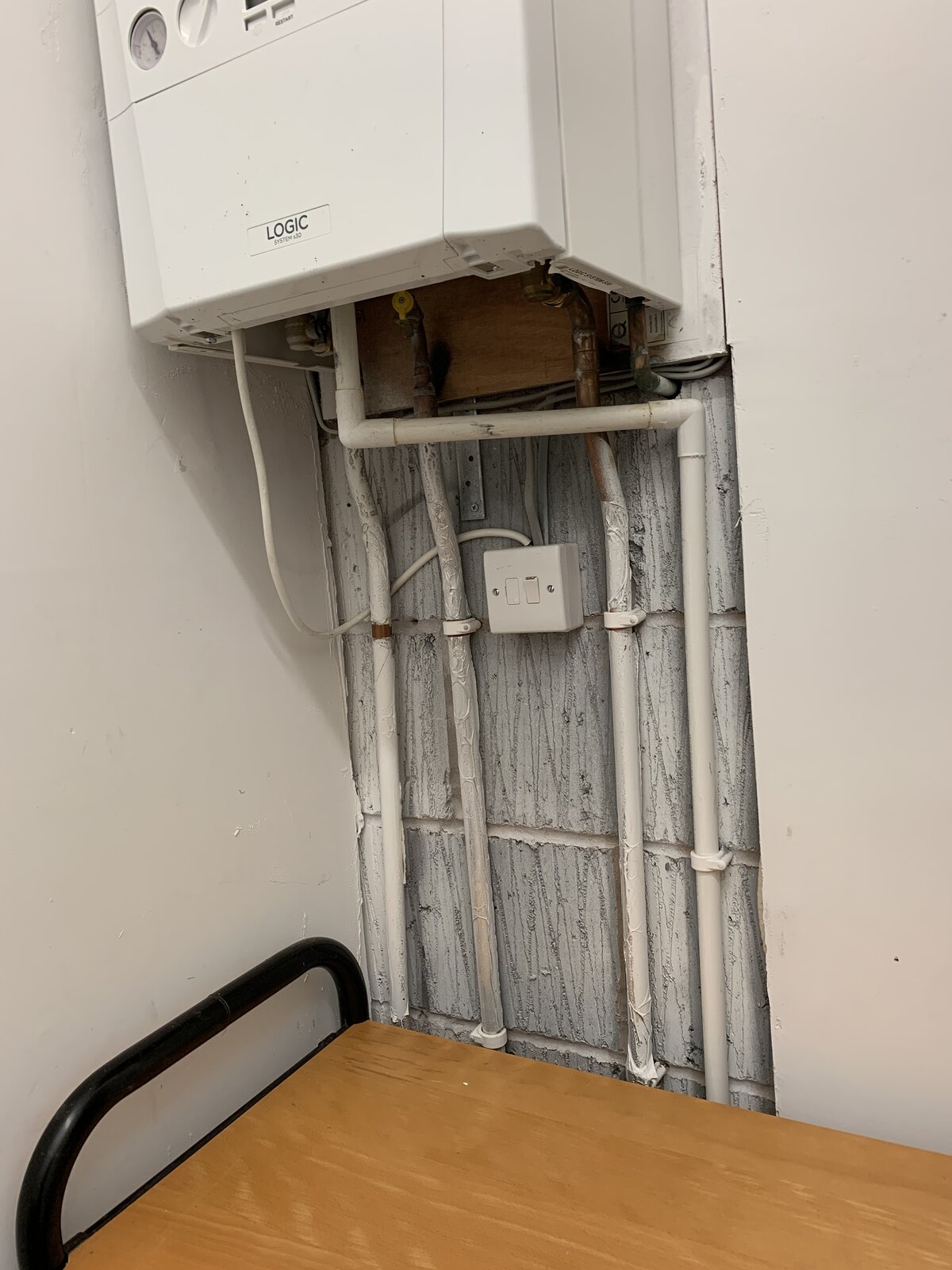

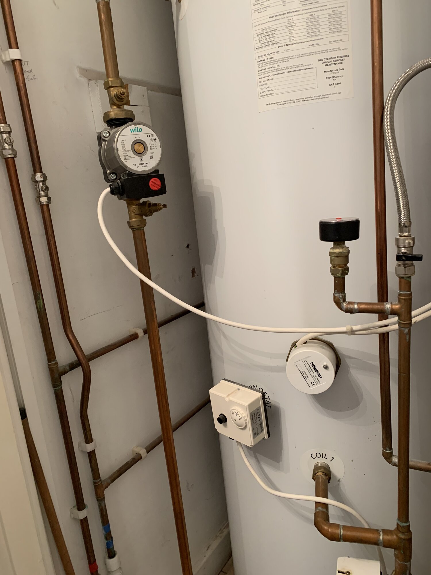

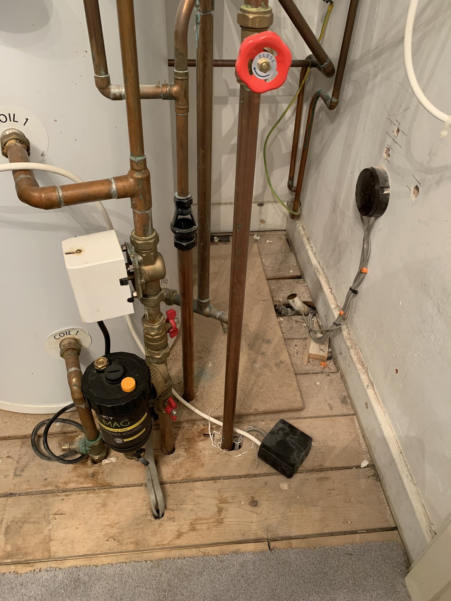

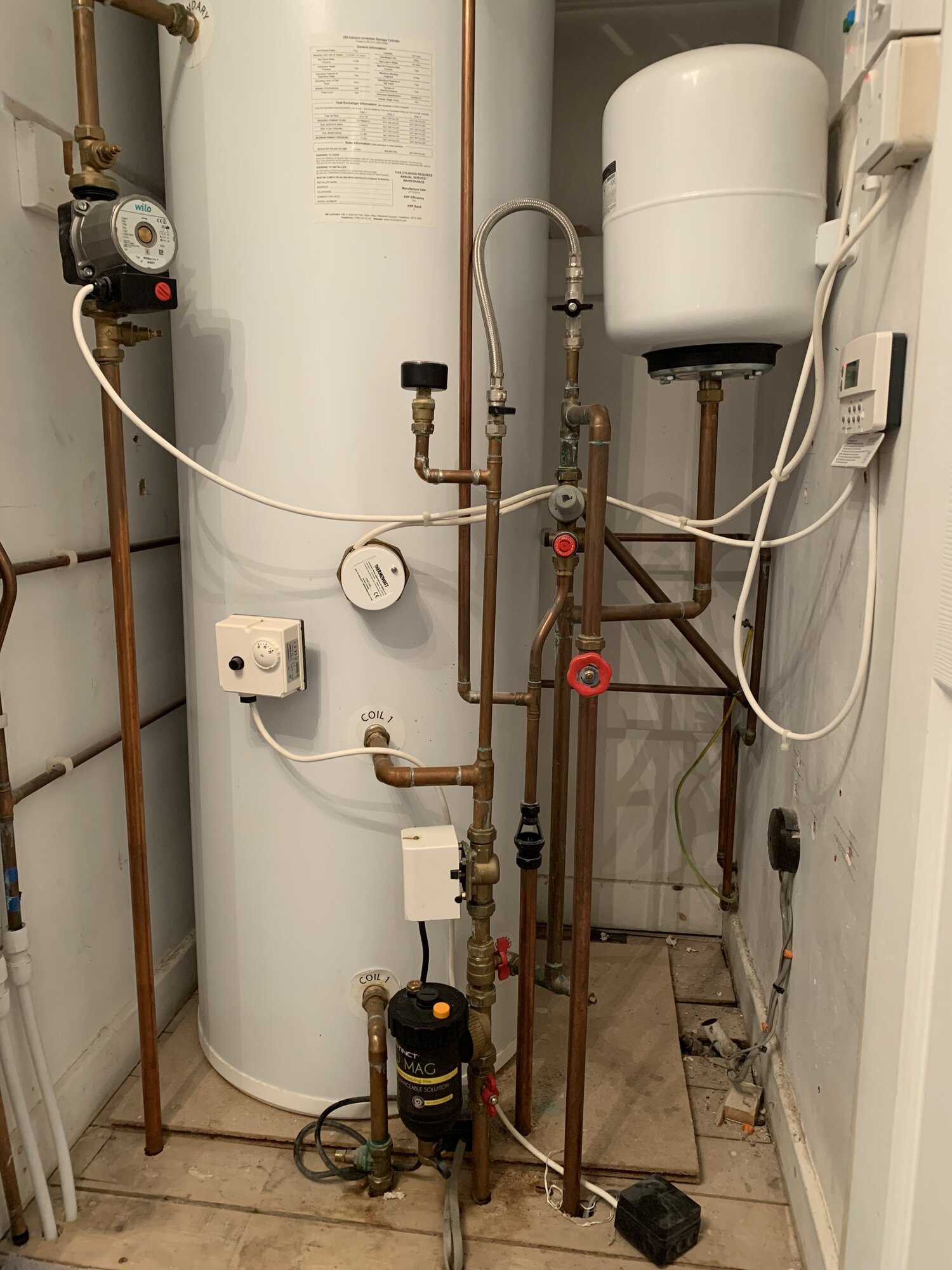

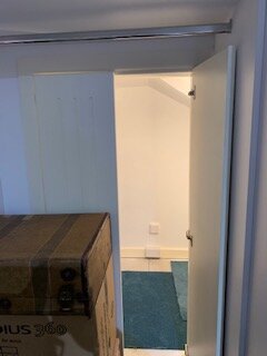

Ahhh...
When we moved into the house, like most people, we had boxes everywhere. One of the bedrooms had sliding wardrobes so obviously we just filled it with boxes of stuff we carry from one house to the next never using any of the stuff.
So as I'd looked everywhere else I thought I'd take a look....
obviously the ghostly light wasn't lit.....
...and opening the door revealed a hidden room with guess what !
So now I can at least do some debugging and see if the receiver is on when I think it should be.
Thanks for all the help so far, I now where the stat is and have gained an extra room !
Cheers,
Dave
