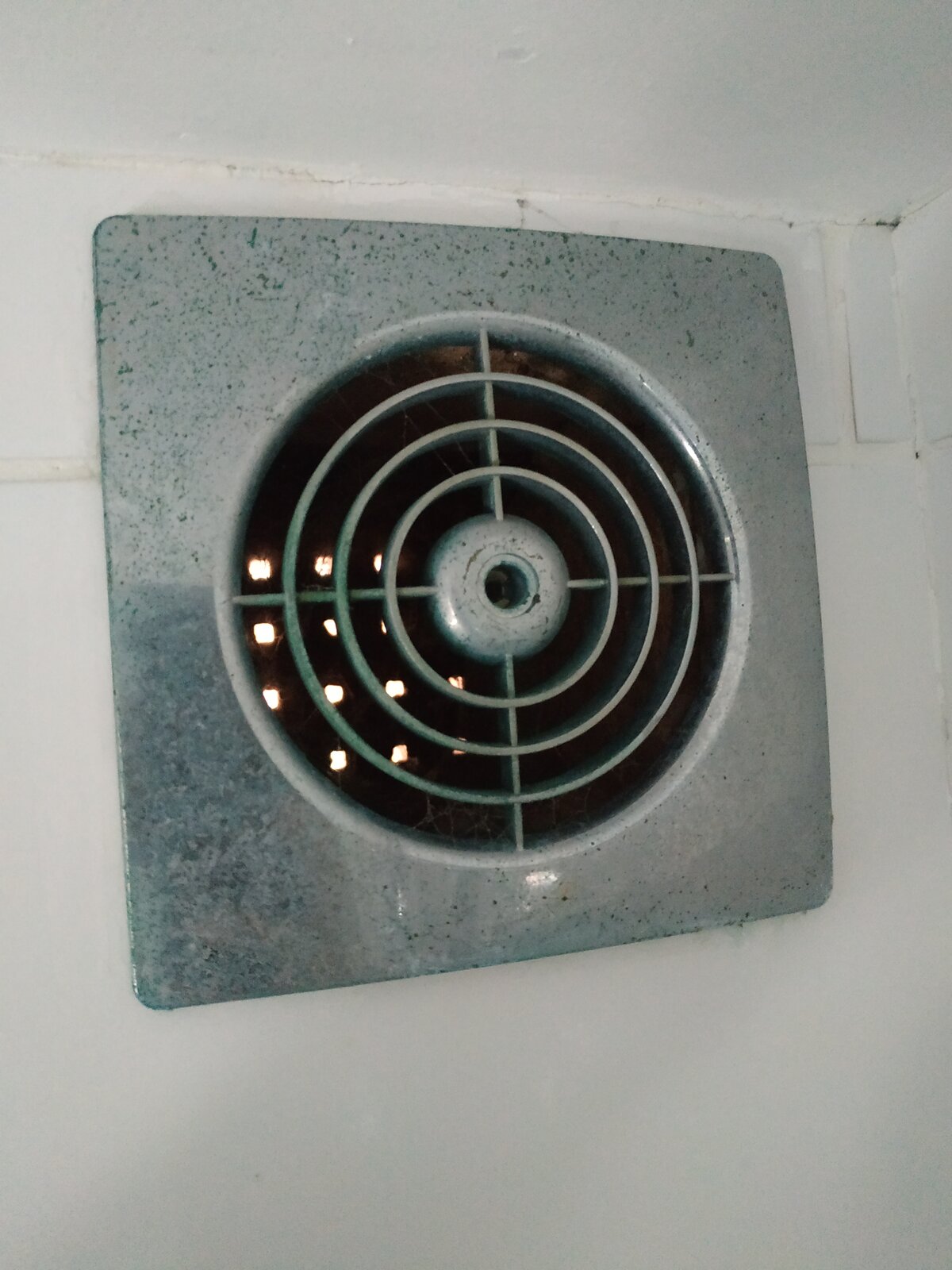

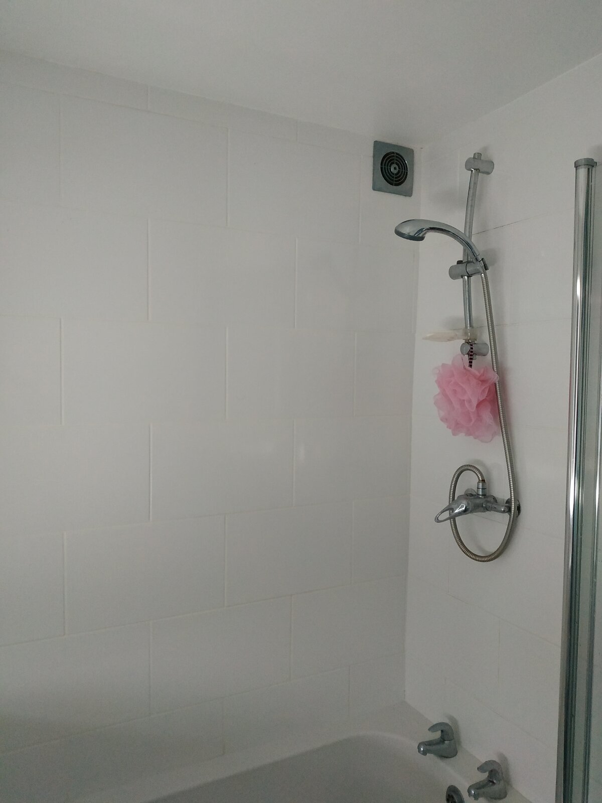

Hopefully the photos will help.
  • Looks like there's no duct inside the hole. On the outside it's a clay airbrick so no flaps.
  • The dimensions are (w)1.96m x (l)1.7m x (h)2.3m. There is a double glazed window that can open.
During the summer it's not a problem because we can simply open the window. We could leave the door open but that seems to set off the smoke alarm nowadays and the landing is fairly cold as well. I'm just wondering, let's say I can get an effective extractor, would that suck out the warmth anyway? So far, despite the walls being so wet after use, the Zinsser wall paint seems to be doing a pretty good job so far after 5 years.

Major consideration/concern is the position. Nobody has mentioned this. Your airbrick hole is within the shower area, and with a ceiling beight of 2.3 metres, that puts (at least some of) the fan within Zone 1. This means that you cannot have a mains powered fan there. You'll need a 12v fan to be compliant with the regs. Do you have access to the roof space above the bathroom?
Re the hole. Easiest way is the install a short length of pipe from the inside so the end is flush with the airbrick outside. To do it properly, you should fit ventilation cowl with flaps on the outside. Make sure the pipe slants slightly from inside to outside so that any water doesnt run into the room. There will be a lot os space around the pipe, that horrible expanding foam stuff is handy here.
Maybe no one has mentioned it is because it is not true - as long as manufacturer states it is suitable for zone 1.
Sometimes you can put a mains fan in zone 1, but in your case, looking at your picture, it is so close to the shower head that it is liable to be splashed.
"Are 230 V extractor fans permitted in zones 1 and 2 of a room containing a bath or
shower?
Yes, a suitable 230 V extractor fan may be installed both in zones 1 and 2, and outside the
zones. If an extractor fan is installed in zone 1 or 2 it must be protected against the ingress of
moisture to at least IPX4 and be suitable according to manufacturer’s instructions. Regulation
701.512.2 requires that equipment exposed to water jets (for example, for cleaning purposes),
shall have a degree of protection of at least IPX5."
