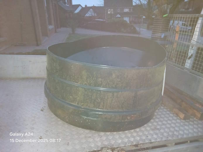

About a year ago, they put gas into our street, and I was seriously tempted. Now my oil tank is close to end of life, so time to decide…
I have an oil boiler which was installed new 8 years ago, serviced every year, provides good heat. It’s on a vented system, which I see no reason to change.
My only real reason for doing anything is the 30-year-old plastic tank, which is definitely showing its age, though no leakage yet. I’ve just had a firm round to quote for replacement.
The job would consist of removing the old tank, transferring about 900L of oil over, putting a concrete base down for the new tank, a little bit of pipework where the fuel line goes into the ground, and installing a bunded tank (there’s a drain a couple of feet from it).

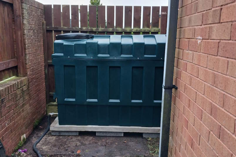

OK, realise nobody can answer this for me so, having thought hard about it, I don't want the hassle of getting gas in (they ruined my next door neighbour's block paved driveway), so new tank it is.
Now I've only got one quote so far - £2145 inc VAT to supply and fit a new tank, remove the old one, and transfer the oil over.
Any idea if that's reasonable? I'm pretty sure the slimline tank they're fitting would be this one - has to be bunded as it's beside a drain.
£1290 on top of the cost of the tank looks steep to me, but what do I know...

Thanks, that's very helpful. They say it will be a same-day job.

Not going to be particularly helpful, but I have experience of replacing the oil tank a few years ago now. They said we couldn't replace like for like because the neighbour had just built an extension (with planning permission) 1 metre from our tank, so we were not allowed to replace our tank as it would be 1 metre from their extension. The compromise was building a firewall in between. There was a load of other stuff involving where the oil would run to if the tank burst (i.e. not down the sewage drain). Sounds like you may avoid these issues.

Yes - the guy spent half the time quoting regs to me - pretty sure it'll be done right (y)
Not a chance.
Now if bodging the job it may be re-use the inadequate (by todays standards) base... when it could be done in a single day.
Umm... he said they'd lay 3 concrete lintels on the existing base, and put the tank on that?
In what ways do you think the base would be inadequate? Seems to have kept the existing tank flat & level for 30 years...
Read the tank manufacturers instructions for the base required.
Needs to be flat and support the entire base plus circa 300 mm all round typically.
and
may be worth reading and a check conversation with your proposed installer may be in order?
(Not sure how they know what's under / how the existing base is constructed to know their add on bits atop it will be suitable support for the next 20 years. Mine had been down for 10 years from new build but was effectively just slabs on a bit of mortar on the soil.)

Thanks - will ask questions, but he did do a lot of measuring round the existing tank and base before saying all would be OK...
Heard banging outside my bedroom window at 07:15 this morning - two hours later, all done. I had to sign some sort of form allowing OFTEC to come and inspect it, so I assume all in order - certainly looks OK to my uneducated eye.
