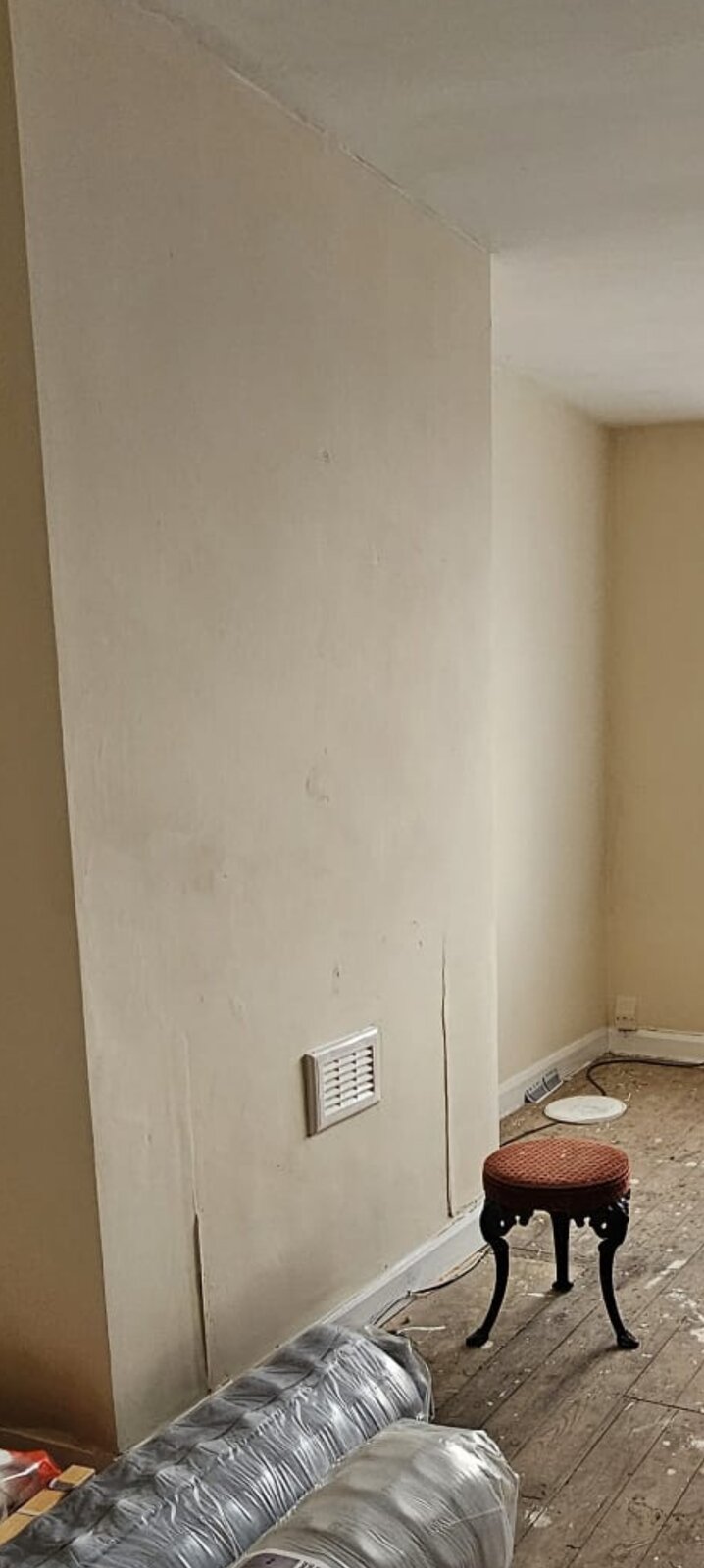

I need to chase a chimney bricked wall ( which has been skimmed) so I can Bury wiring in some trunking to put a TV up.

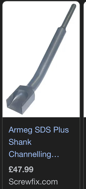

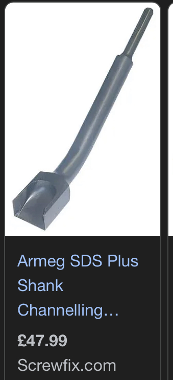

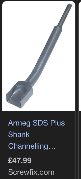

If you have an SDS drill with a hammer feature then these are great
Yes, they're great. I found one (plus a couple of other chisels) in a set of 'large' SDS drills I bought a while ago and didn't initially realise/understand what it was for - but since I found/worked out, I've been very pleased! - and the whole 'set'cost me less than Screwfix are selling that one chisel for!

So THe tv will go on the breast.
Baring in mind there's a carpet there now...
What will be the best method to get a double socket behind the TV . Side of the breast ins a switched fused box.
also behind where the fireplace used to be seems hard and not hollow when I knock on it. It might be filled with brick at the back.

Definitely not (make as much mess as the grinder).
In terms of mess, there's probably not much to choose between the 'scooper' and manual chiselling - but the former will be much easier/quicker. Both produce primarily 'small bits' of plaster, and just a little dust and even the dust is relatively 'coarse' so will essentially 'fall' (onto dust sheets over your new carpet, one hopes!). On the other hand, a grinder will fill the entire room, and quite possibly much of the house,with clouds of fine dust,which will take for ever to totally get rid of!

Thanks for that. Deffo made my mind up. Will use the scooper and sds drill.

Thanks for that ... I have posted the pics above of the chimney breast. If you don't mind can you show me how you'd go about doing it.socket will be behind the TV, if I chase down to the vent can I let some wire hang behind the vent without trunking ? And then chase below the vent and and add more trunking ??
Also by taking the vent off I possible can see how thick the plaster is ??
Lastly, should I then pull the carpet and let the cables go under the floor boards or can I take them horizontal ?

The TV should be fitted so the middle is just above eye height as you sit on the sofa, for me that means the bottom of the 55" TV is 2 foot off the floor.
So in your case that looks to be just above the air vent.
The easiest way is to drill a hole in the side facing the triple socket low down just above the skirting into the chimney space then take off the air vent cover and reach down through it and pass through the hole you just drilled an extension lead with the plug cut off leaving the trailing socket on the other end which will be left inside the chimney space, then drill a hole behind the TV and after cutting off the TV plug pass that wire through the hole and via the chimney space bring it out of the open vent hole where you can then work on re attaching the TV plug which then plugs into the trailing socket you just put in. The the whole thing is then left inside the chimney space.
Only 2 holes drilled and no chopping in needed.
Better yet - if your tv's power cable is an pluggable one then just get a longer one and do the same but without the extension cable.
One thing though the 3socket - where does that surface mounted trunking come from/ go to because by the looks of it its single trunking indicating that the 3 socket is perhaps already a spur so you cannot run an extra socket off it but you can use a flexible extension cable.
