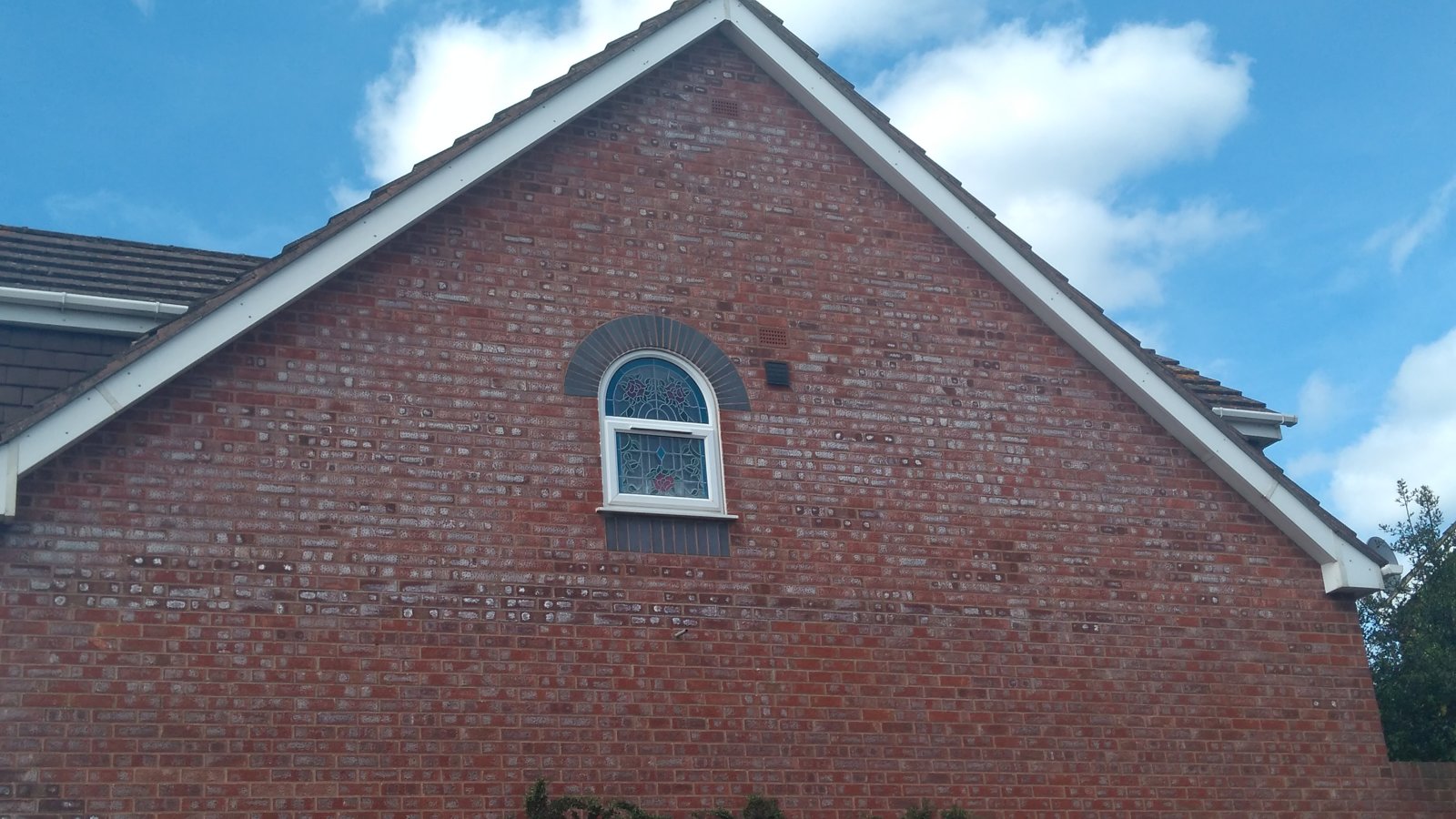

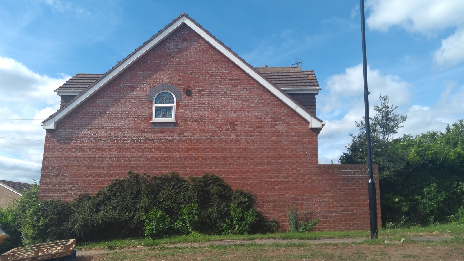

Hi all
Could anyone tell me what would cause these white spots on the bricks?
Any advice how to get the bricks back to normal?
It appears to be on majority of the wall
The room above is a stand up shower, basin and toilet
And down stairs is a toilet and basin

We've just purchased the house, spoke to the neighbour who said its been like that for many years!
When it was built, the builders either let the bricks which they built that section of gable from or the insulation inside it get soaked and when it dried off, that's the result.
Poor site management and quality control, but they will tell you "it's natural, it will go ..... eventually". The only positive is that it's unsightly but not detrimental. Nothing will make it go either, so don't believe anyone who tells you otherwise.
"the builders either let the bricks"??
Unsure as to when it was built, so no chemical cleaner will remove it?
You can brush it off, but it'll come back. As said , probably soaking wet bricks, it will go eventually, but eventually could be a long time. Again as said not structurally detrimental, just unsightly.
I'll give it a go with some chemical cleaner
Thanks all
