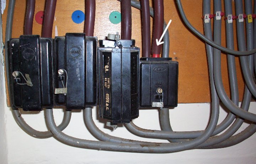

Quite - that's much the same as I said a couple of posts ago. Even without resorting to extreme scenarios, I very much doubt that, in practice, In will hardly ever be appreciably greater than the highest of the phase currents - so I remain doubtful as to whether it is appropriate (particularly in my domestic installation) to have a neutral conductor with a higher CSA than the phase ones....
... and, in case you don't believe me, I think you can see that the ca ble in the bottom of the neutral Henley is larger than anything else ...
... and (as commented before) note the red visible insulation on one of the neutrals (now covered with grey silicone by the most recent meter changer!) - doubly noteworthy because (a) it is visible and (b) it is red!
Kind Regards, John
What happened too my piccie? Maybe too large ... try again ....
Kind Regards, John
Kind Regards, John
I promise I have seen far too many dalliances from the norm or regs to disbelieve people.
