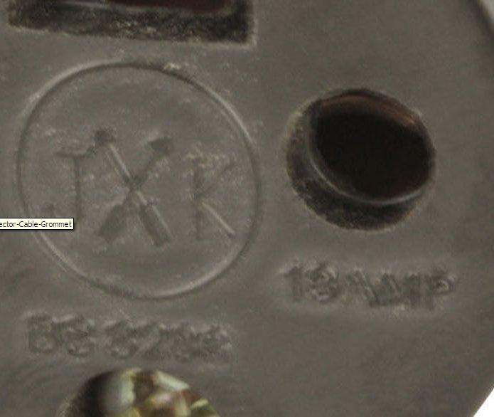

A 2200W kettle is 10A and all the 3000W kettles I can find are classed as cordless so don't use a C15A IEC 60320 connector. The old
connector I can find no info as to rating. Although described as "Universal 13 Amp Round Pin Kettle Plug Element Connector & Cable Grommet".
As to fitting a 10A fuse in a C15A IEC 60320 connector attached to a 13A plug yes it would seem correct but if I was doing a inspection of in-service electrical equipment and a 13A fuse was fitted I would not change it or fail it.

The old
Although not the best of images, it is, indeed, clearly marked "13A" but I can't confidently read all of the BS number.....
