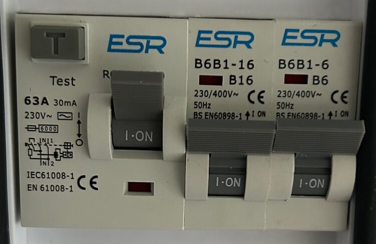

Does not matter, as supplied from the clients home, although that seems odd, I know I don't have a 16 amp supply 1714406858437.png on a TT earthing system suitable to supply a caravan type vehicle, that is only likely to be found on farms and the like. This is why I had assumed using an inverter may have been the problem.

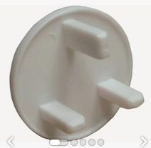

The plug should be mat black as that colour can radiate heat better, but the problem is removing the heat from the fuse for a prolonged time, the 13 amp plug and socket was developed near end of second world war, but it has been modified, the solid brass pins have been replaced with safety pins, with reduced cross sectional area where the insulation has been added. It depends on a good grip in the socket so some heat can be got rid of through the pins, so all it needs is for a socket to be strained by some one inserting a non BS 1363 item like this 1714407739972.png and the socket can be strained so no longer able to dissipate the heat.

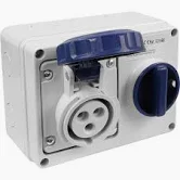

so possible the fault is the customers socket not the 13 amp plug. I had looked at this 1714408058370.png and had assumed plugged into a 16 amp supply. For EV cars when using a granny supply it is limited to 2 kW they do not attempt to draw 3 kW from a 13 amp socket, I would say the problem is simply drawing too much current for too long. One should not draw more than 2 kW from a ring final without being sure
