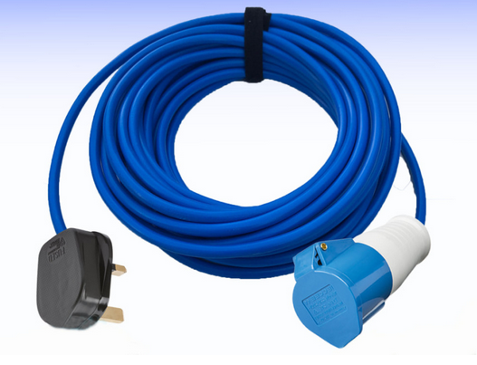

Thanks for that. The plug is on the 16 amp lead that supplies the van, it has the standard 16 amp round pin socket that plugs into the van on one end and 13 amp 3 pin socket that plugs into any domestic 240 volt outlet on the other end.

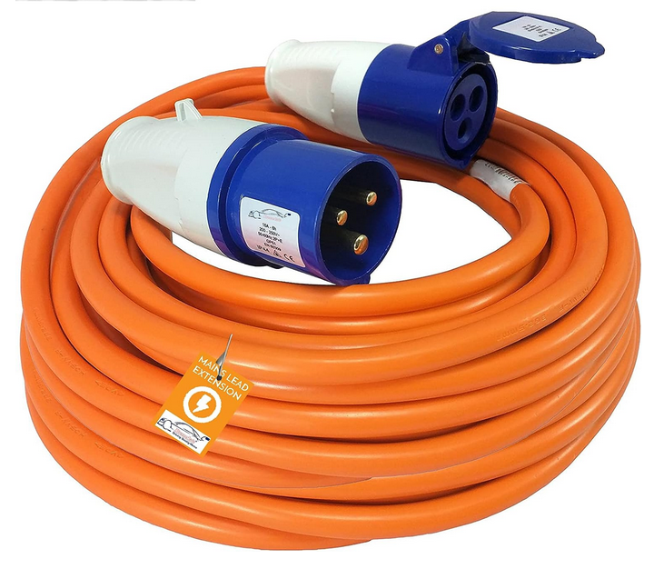

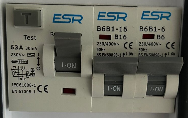

So you are talking about one of these 1714500997831.png which is supplying the van 22 amp consumer unit with a 13 amp fuse, and one wonders why it gets hot? I have seen these 1714501169051.png where the 16 amp feeds the 6 amp so total 16 amp, but in the main they rely on the caravan site having an overload at 16 amp and using a lead like this 1714501328612.pngwhich should be 2.5 mm² and no more than 25 meters long. However the bit
708.553.1.14 Socket-outlet protective conductors shall not be connected to any PEN conductor of the electricity supply. For a TN-C-S system, for a supply with a PEN conductor the protective conductor of each socket-outlet shall be connected to an earth electrode and shall comply with the requirements of Regulation 411.5 for a TT system.
is the main bit, most homes have a TN-C-S supply, so she would need to not use the earth and drive a stake into the ground instead. That is clearly not going to happen, so only option is a generator built into the van.
.... the van 22 amp consumer unit with a 13 amp fuse, and one wonders why it gets hot?
Well, yes, if (as we have been told) the total load is not much over 10A, I would wonder, wouldn't you?
Adding up the MCB ratings, in the way that you've done, is obviously no indicator of the size of the actual load - I;'ve just looked at the ndearest of myt CU's, and the MCBs add up to 152A, but that doesn't mean that the 60A DNO fuse protecting it gets particularly hot :)

Yes that's absolutely correct, the only current draw at any one time is use of the 2400w appliance and 35w total led lights.
So, if you draw 2400w+ through a 13A plug/socket constantly it will get hot, no if's buts or maybe - it's going to get hot.
That is because the plug/socket interface is not really designed to take constant higher currents.
This is why your 16A lead should really have a 16A blue plug on it also, it's designed for a higher load.
