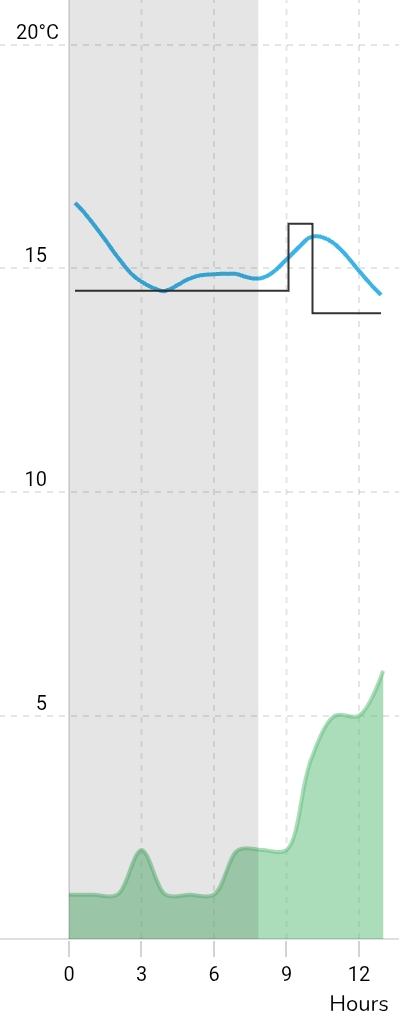

What does Hive tell you? This system has graphs 1771083649046.png I am sure Hive is the same, it shows when there was a demand, and how the room responded, both Wiser and Kasa do this, so I can see how well it has done. Nest is a bit useless, it shows energy history which shows how long it asked the boiler to run for, but not how long it actually ran for, or any temperature graphs, so all in all Nest is a bit like a chocolate fireguard. The Energenie TRV heads also do not show any graph, only target and current temperature. With is better than eqive TRV, which only shows target, but they were only £15 each, so can't really complain.
I was uncertain as to if to go with Hive or Wiser, I went with Wiser, but note Hive now is a whole range of thermostats, not just one, each with different features. So I have no idea what yours will show you?
