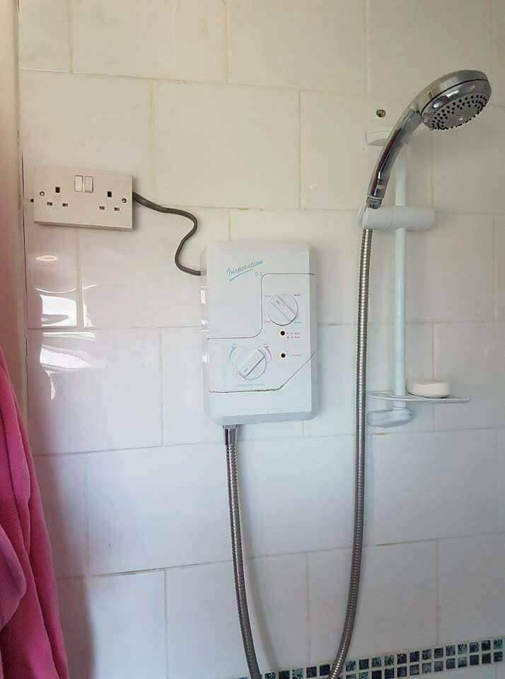

This one's handy to plug the hair dryer in without getting out of the shower
Reminds me of those "Dolphin Showers" a few years back.
The number of times I found them wired back to back with a bedroom socket on the Ring Final via a length of 2.5 T & E, I think they were around 6KW , blooming massive housing with an element of a wire coil in a perspex block as the heater
What danger(s) did it present?
A cable in the wall with a buried junction box would be allowed, wouldn't it?
As it happened, the grout was failing in that area. I didn't fancy water getting into the junction box with me being wet and naked very close by.
Maybe the risk was very low, but I'm not a massive risk taker and as soon as I knew about it, I rearranged the ring final legs to exclude that socket.
Would you have been happy to leave it there?
I would not be. I might be sneaky enough to leave the socket nicely showing inside the shower cubicle to see what a talking point it might be.
Some folk would look and not even notice.
How well does electricity flow through clean water?
Seriously?
Am I the only one who can see that whether the cable & JB should be buried in ANY wall is dependent on issues totally unrelated to whether it can be in a tiled wall of a shower enclosure?
When we redid our ensuite, I smacked the tiles off the wall where the shower was and there was a double socket box with live cables terminated in a junction box buried underneath the tiles...
So, in order to avoid any doubt, uncertainty, misunderstanding, or not grasping what the key issue is, then assuming that it was OK for that double socket box with live cables terminated in a junction box to be where it was irrespective of whether the wall was painted, wallpapered, panelled or tiled, and irrespective of whether the wall partly enclosed a bedroom, or a living room, or a hallway, or a WC, or a kitchen, or a bathroom, or a shower,
