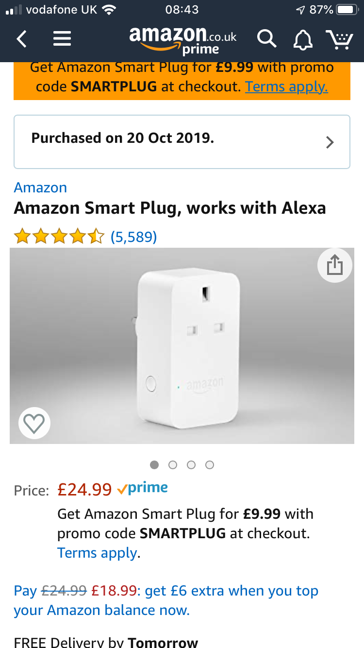

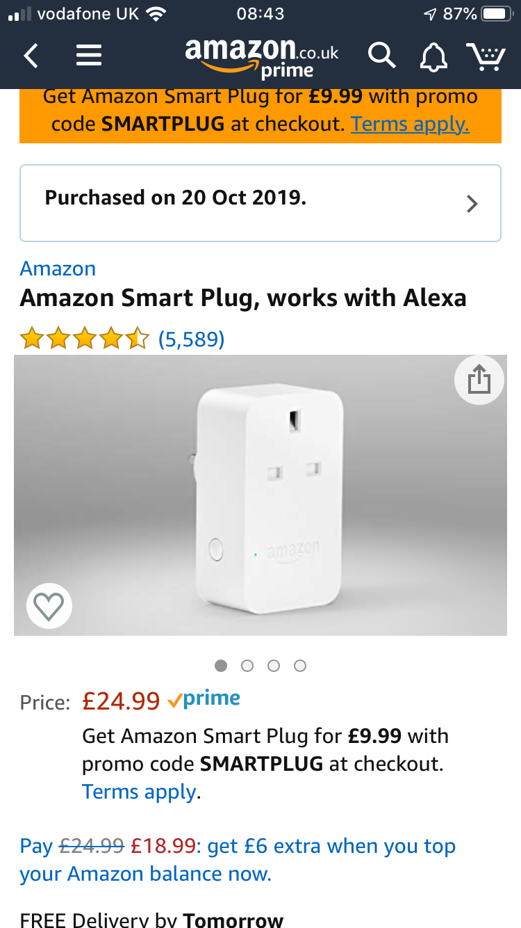

    amazon have a deal on their SmartPlugs. Normal price £25. Offer price £9.99!
    Controlled by Alexa, you may need to be aa amazon Prime customer. Oh, and limited to one per customer...
    edit. Shouldn’t it be Smart SOCKET???
