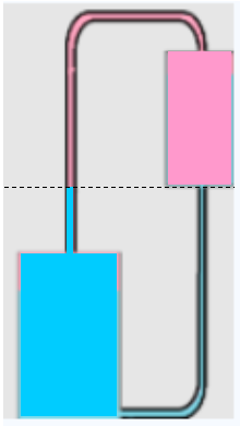

I would say that at first glance this does not look possible:
So would I.
However, perhaps it is just not coloured accurately. .... For example perhaps nearly ALL the water in the Willis should be pink and indeed pinker - i.e. hotter and less dense - than the water in the cylinder by the time it has been moved so that circulation will be maintained - albeit slowly. ....
Yes, I would say that's how the diagram should have been coloured, but that doesn't alter many failure to understand how it is possible that the depicted system could 'work'. In particular, I'm finding it hard to see how your 'levelling' argument could explain how it would work, because I would have thought that the 'circulation' would stop once one got to this point....
