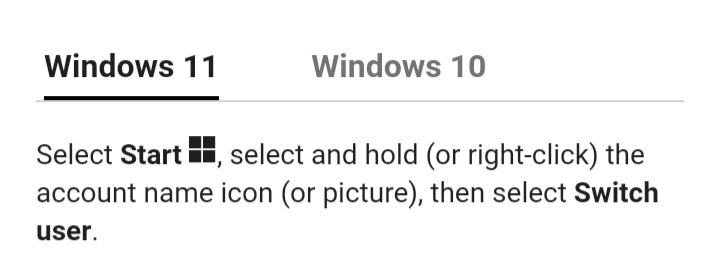

Have you tried 'switching user' to the admin account?

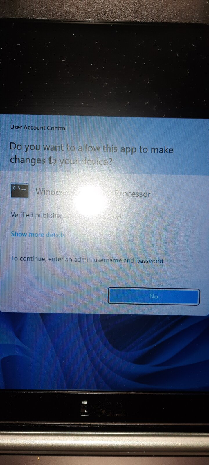

Tried switching user, Everthing I try i seem to get
The image definitely shows you have no admin rights on that account. If you did, there would be a yes button!
