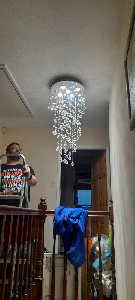

We have to use some common sense, and in hind sight, when I fitted this lamp 20220529_211956.jpg fitting the relay inside the lamp was not the best move, as to get to it, even if it is only behind 5 knurled nuts, as to remove all the dangling bits will take some time. It may never go wrong, but if you make it hard to access, you can bet your life you will want to even if just to fault find, and nothing has gone wrong.
