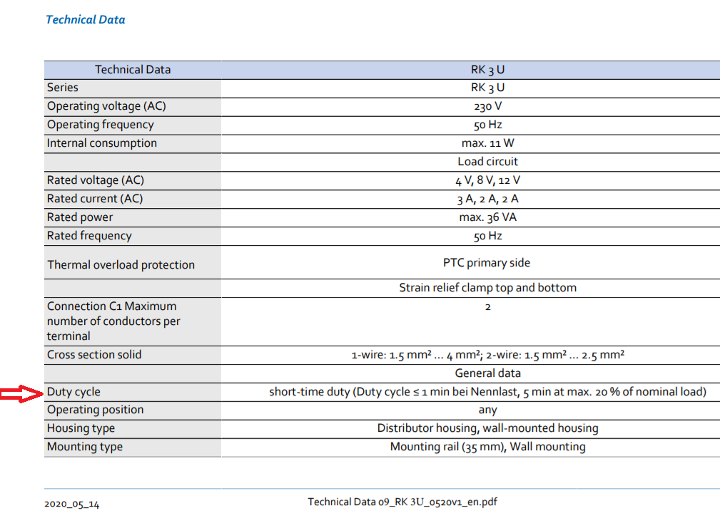

Another myth like the one about shaver transformers. No bell transformers that I’ve seen come with such a warning. It is common for them to continuously supply a light in the bell push.
Finally found a reference to EN 61558-2-8
Quoting from:- ABB_Modular DIN rail transformers_Brochure_EN.pdf
Website https://library.e.abb.com/public/ad...Modular DIN rail transformers_Brochure_EN.pdf
What do fail-safe transformer and non-inherently short-circuit proof transformer mean?
Fail-safe transformer:
Permanently fails to function during overload or short-circuit presenting no danger to the user or surroundings.
It can be equipped with an external protective device, which reactivates after fault resolution.
Non-inherently short-circuit proof transformer:
Equipped with a PTC protective device which reduces the current in the input circuit when the transformer is overloaded or short-circuited and
continues to function after fault resolution.
How long can a bell transformer supply power?
The reference standard EN 61558-2-8 does not specify a specific time but states “Bell and chime transformers are generally intended to supply domestic sound signalling equipment and other similar devices where the load is applied for short periods of time.”
Moreover, regarding temperature testing it says “Temperatures are determined during a cyclic test of 20 cycles, each cycle consisting of 1 min operation with the simulated full load and 5 min operation with a load of 20% of the simulated full load.”
Therefore using a bell transformer for continuous use determines a temperature rise of the transformer which could cause it to stop supplying power, unless the work/pause cycle allows the transformer to sufficiently cool down.
Is it possible to downgrade bell transformer’s power to use it continuously?
Using a transformer to supply a lower load than the nominal power reduces the power loss containing the temperature rise of a bell transformer used continuously.
Nevertheless a lower load than the nominal one destabilizes the voltage output, which by standard has a tolerance of 15% at full load but 100% with no load!
Since the relation is not linear, a transformer working closer to no-load conditions could give a voltage output between 15% and 100% higher than the nominal secondary voltage, endangering a device sensitive to voltage variations
