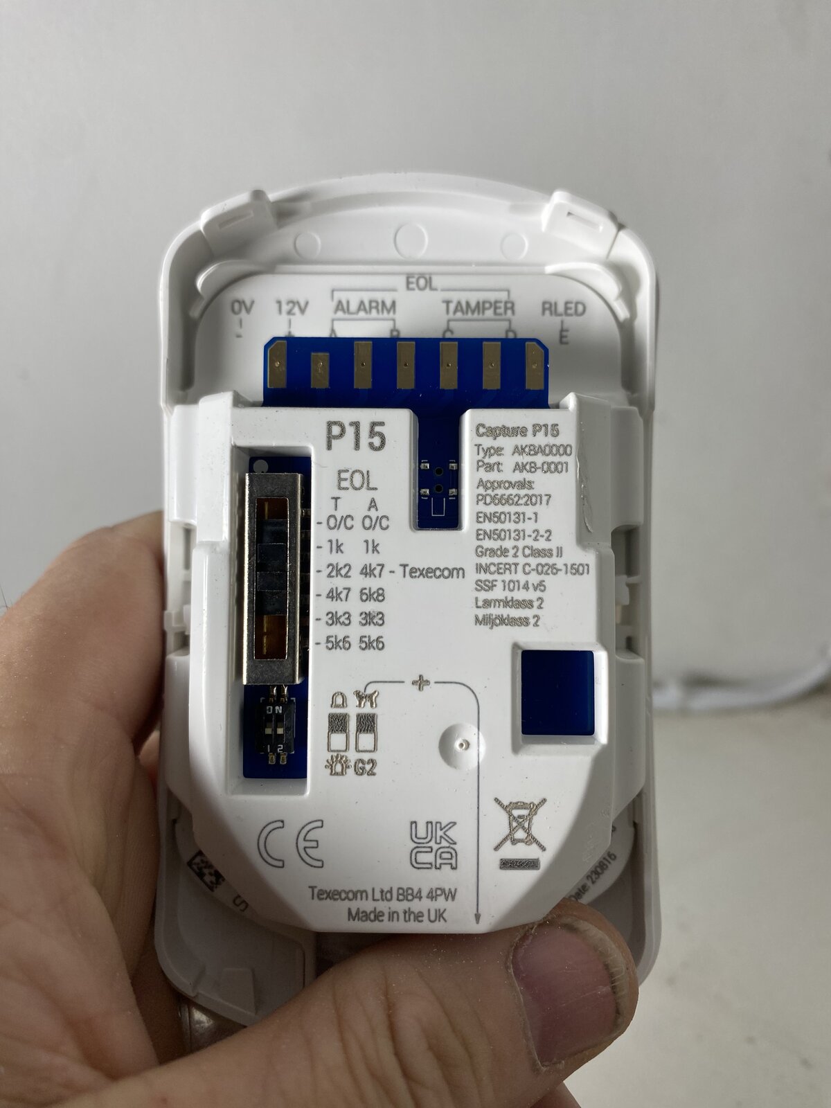

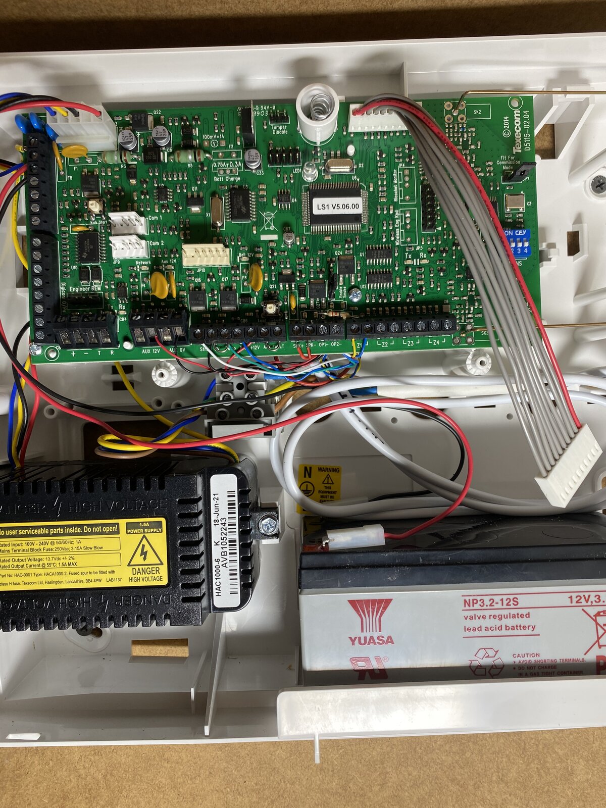

Hi
I’m having an issue with a wired PIR on a Texecom Capture Ricochet 64-W Wireless Kit 2
both the PIR and the panel is our first time setting up like this.
We normally install the excel panels. So this is quite different.
I have wired one PIR to zone 1 using blue and yellow and red and black to Aux 12v and 0v. We have not connected a tamper for this as I can’t see it on the panel.
At the PIR end we have wired 4 cores,
* black and red to - +
* yellow and blue to alarm
* Resistance set at 4k7

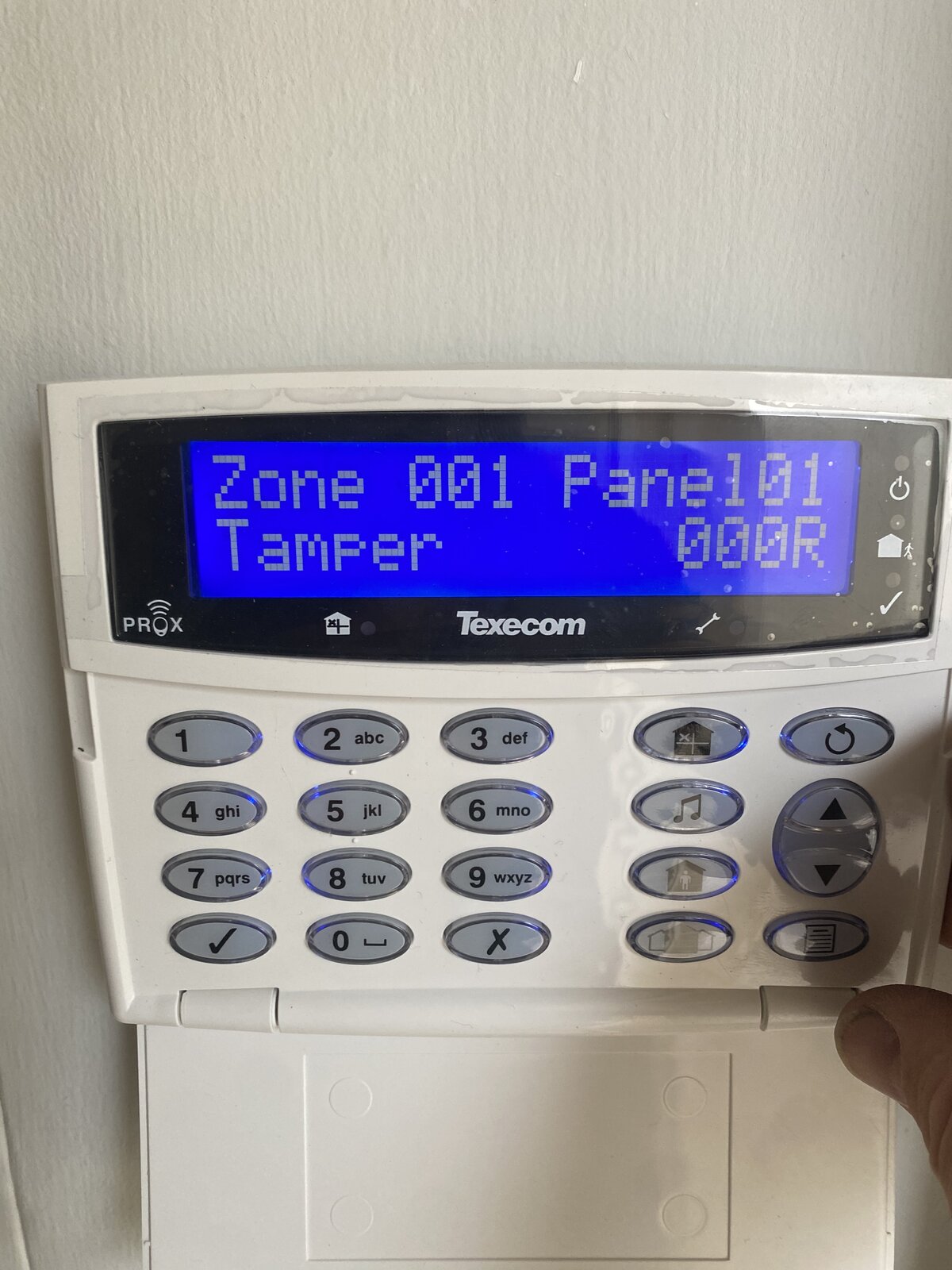

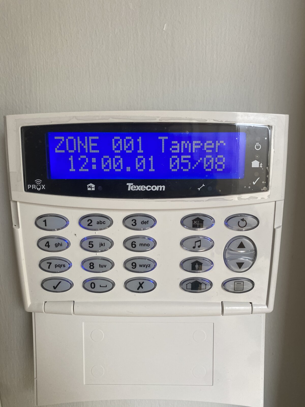

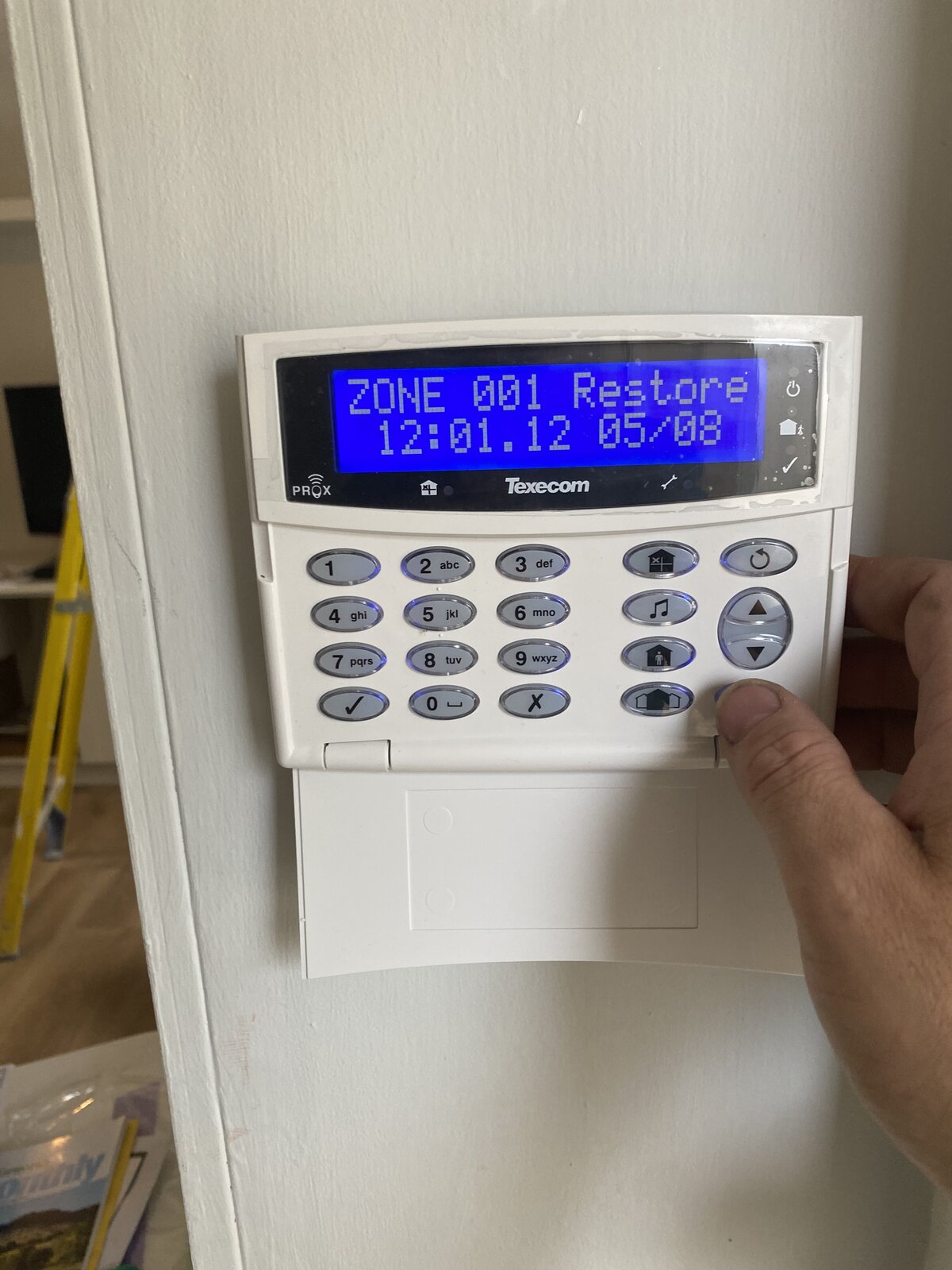

Zone 1 keeps showing tamper What am I missing?

Power + red black - A yellow, D blue set to 2k2 4 k7. zone wiring type double pole eol
