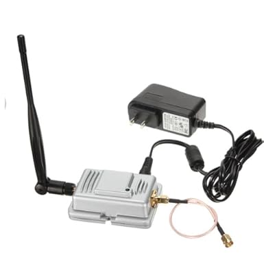

What did work fantastically well were these two aerial "boosters":
Option 1 (£10): TP-Link TL-ANT2408C Omni-directional antenna
Option 2 (£27): 2W 2.4Ghz Wifi Wireless Broadband Amplifier Router Power Range Signal Booster
Option 1 on it's own extended the range by about another 10-15m.
Option 2 on it's own extended the range by about another 20-30m.
I didn't test both in series (option 2 connected to the camera with option 1 connected to the booster) but that would probably be a good combo.
I found the aerial boosters on Amazon but you may find cheaper on eBay or elsewhere:
Option 1: http://www.amazon.co.uk/gp/product/B001PSB582/ref=oh_details_o02_s00_i00?ie=UTF8&psc=1
Option 2: http://www.amazon.co.uk/gp/product/B00BT9CKXQ/ref=oh_details_o04_s00_i00?ie=UTF8&psc=1
The option 1 and option 2 areal boosters are mounted neatly in the roof cavity on the rafters (both come with mounting points) with the leads all going away from the cameras towards the centre of the house.

Hopefully this info helps others decide, but I'm more than happy with these cameras as reception is good throughout the house and garden wherever the folks take their monitor. Not surprised using both signal booster options in series. And Maplin have dropped the price to &169 recently too.
