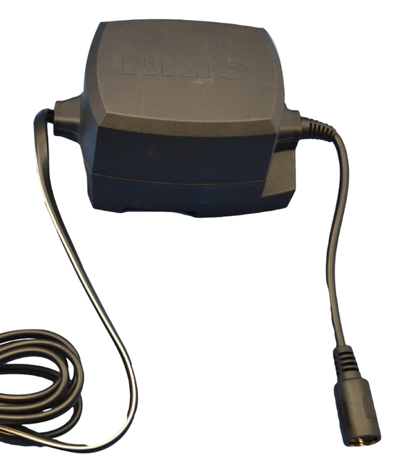

We've just bought a recliner sofa and chair from DFS Both electrically powered by battery which they claim will last up to 6 months before needing charging again. First charge took 16 hours but subsequent charges should only take 8-10 hours. When they are due we will simply plug them in overnight and put the chargers away again. Been working very smoothly for just over 2 weeks now and no wires on show as each unit has it's own battery pack which tucks underneath at the back.
I'll see if I can find out any details on the chargers when I get a chance.
Here's a photo of the battery pack for my wifes chair. Hope this helps.

I have 4 chairs bought at different times with recliners, all seem to use something that looks like a hydraulic cylinder, or linear motor, and DC, all use a power pack that looks like this upload_2022-3-8_9-38-31.png with the extra low voltage connector that looks like the plugs and sockets used for speakers, and under the pack are two PP3 batteries which will work chair once in the case of a power cut.
