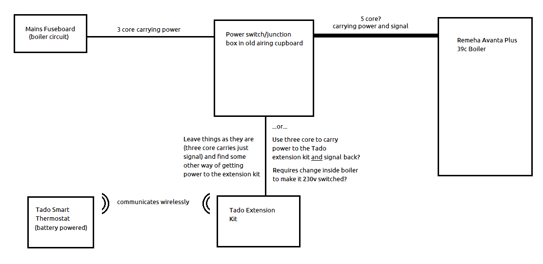

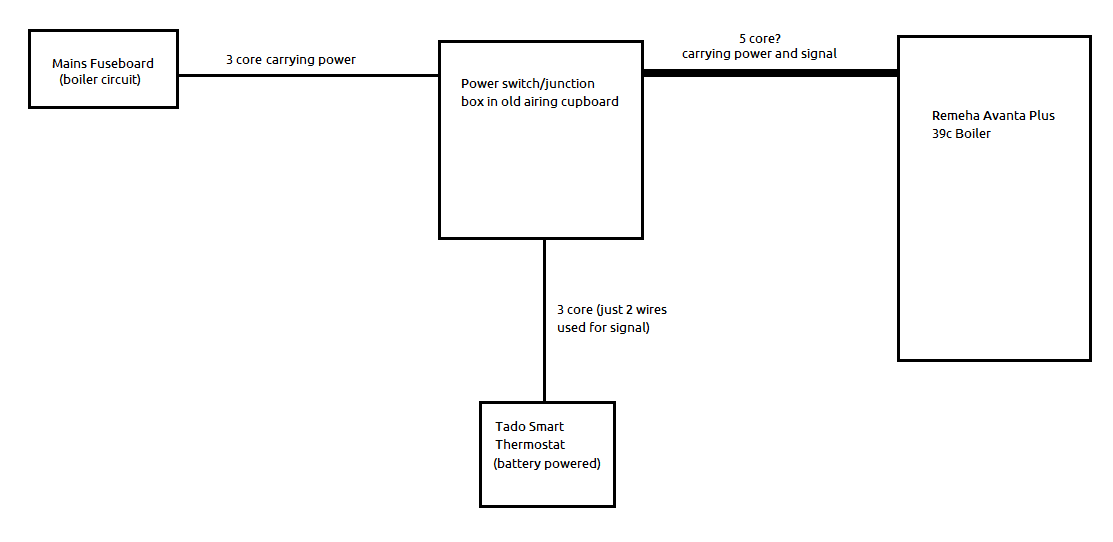

I have a Tado smart thermostat and it's all installed and working fine for the most part. The only niggle is that it's sited where my old thermostat was (in the hallway) which isn't a very representative place to measure the living area temperature of my house of course. I therefore would love to be able to move the smart thermostat to my lounge. Handily, the thermostat is battery powered and can be made entirely wireless by adding a Tado "Extension kit" into the system.
The Tado Extension kit just replaces the smart thermostat, turning the boiler off an on as required via its signal cable (when the thermostat tells it to). However, unlike the thermostat, the Extension kit needs its own power supply. It comes with a fused (3A) three pin plugged cable that ends in Live and Neutral bare wires.
I got a local electrician round to wire in the Extension kit, I thought it would be as simple as either taking a direct feed from somewhere, or worst case, installing a power socket near to it and using the supplied 3 pin cable.
He was very helpful, but said that the way the boiler and stat are wired currently doesn't really comply with modern regulations. In that it is kind of mixing 230v wiring and low voltage signal wiring within the boiler circuit (and having two different voltages on a single circuit is bad practice apparently?).
He's suggested that the better/safer solution (and neater too since it wouldn't require any extra cabling) would be to change it to be be switched 230v. My boiler (Remeha Avanta Plus 39c) can be wired in a few different ways, but changing it would mean opening the boiler which obviously the electrician isn't certified to do. He said that if a heating engineer changes it to 230v switched live, the three core wire that already runs to the thermostat currently could bring power and the switch signal.
I'd love to know what do you guys think? Does that seem like the best way? Is there any downside to going 230v switched live?
I just want to get a sense of whether it's a job for a heating engineer (as the electrician suggests) or if it would be worth just getting another electrician to have a look.
Let me know if you needs any photos or wiring diagrams for the stat or extension kit, I've got the boiler manual too if the wiring pages from that would help.

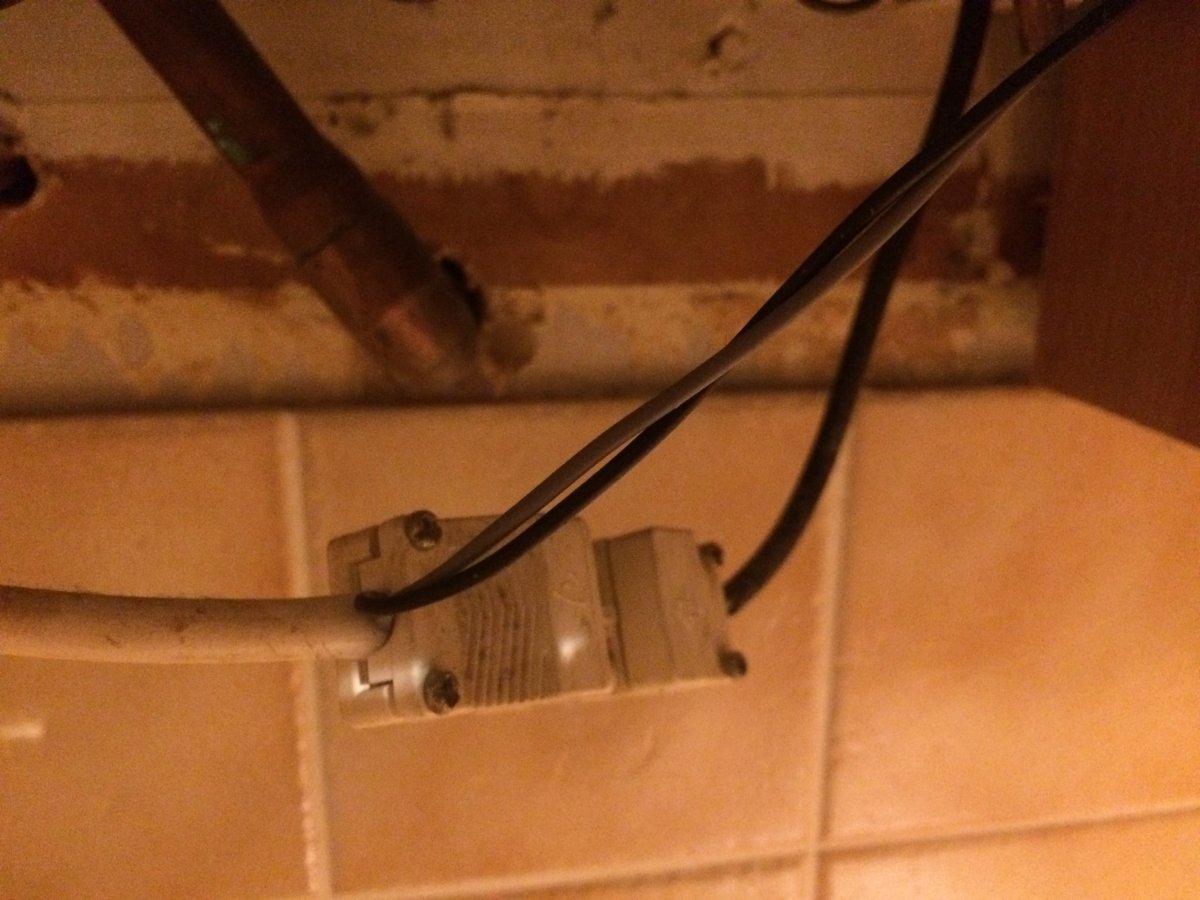

The regulations state that a cable or cables carrying different voltage bands must be insulated to the highest band - e.g. 230V.
So, it depends on the type of cable you have - probably alright if suitable for 230V.
If requiring a change then opening the boiler will be necessary.
This depends on the type of boiler.
If the outer casing IS the combustion chamber then, strictly speaking, you need a gas qualified 'engineer'.
If it is one with just a decorative outer cover then anyone can do it.
Thanks so much for that, yes unfortunately on my boiler, the outer cover is the boundary of the sealed combustion chamber.
As you can hopefully see in the attached pic, the wiring as it arrives at the boiler (from the switch in the old airing cupboard) comes from a thick white cable (8mm) into a junction box and then a thick black cable (power I guess) comes out of that into one part of the bottom of the boiler and a pair of thinner (presumably signal cables) goes into another part. So it would need to be a Gas Safe engineer if we go 230v switched, to change things inside the boiler, I guess.
Is it worth going 230v switched do you think? Any downsides to going that route?
