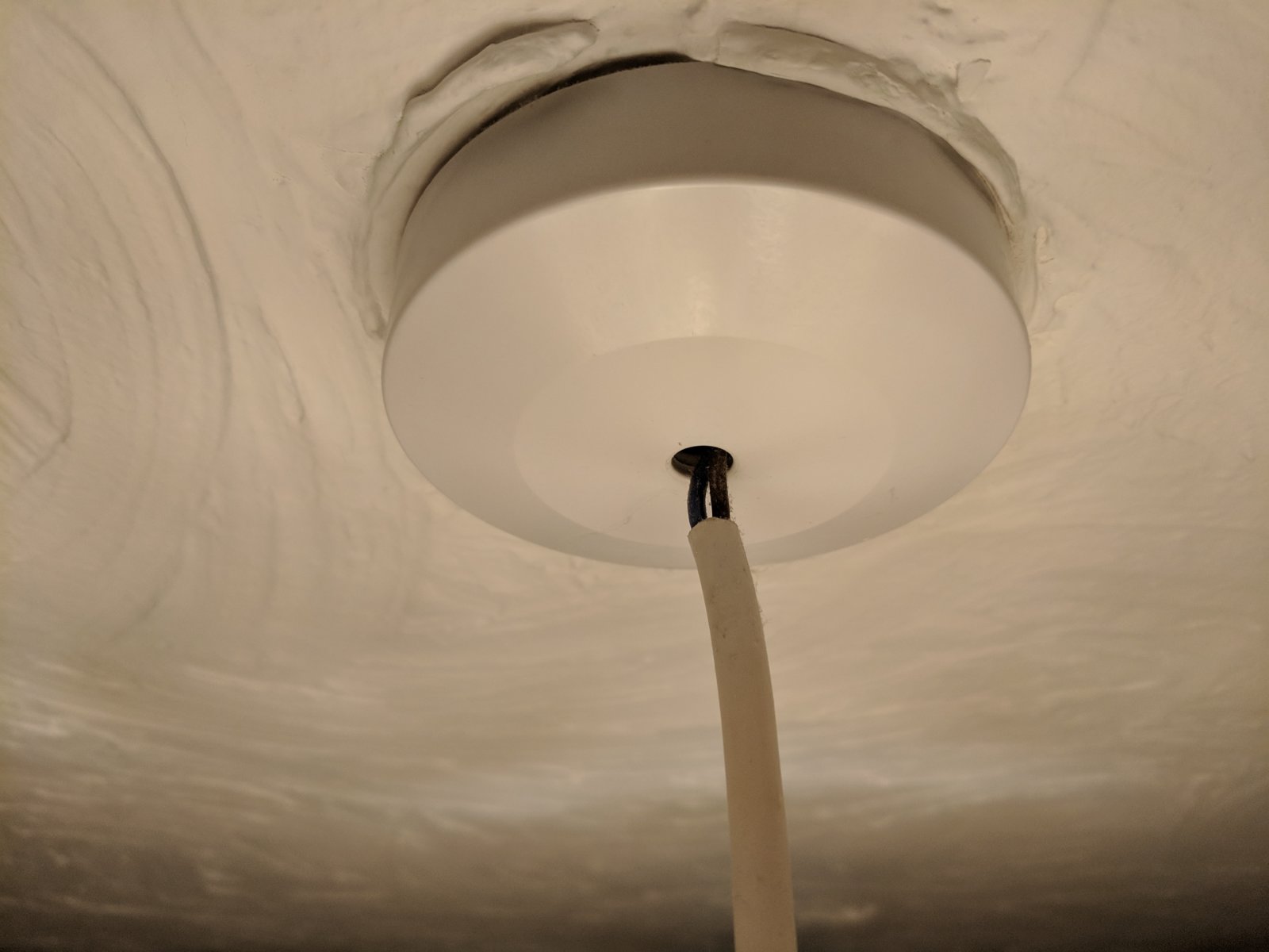

When I was putting a light shade up, I noticed the blue and brown wire at the base of the light fitting are exposed. Is this anything to worry about? And how would I fix it? Thanks!

Not very nice. Those blue and brown wires should be hooked around clips within the ceiling rose, and short enough that none of the blue/brown (only the white sheathing) can be seen from below. As things are, it's quite probable that they are not 'hooked' and therefore the weight of the bulb/lamp will be trying to tug the end of the wires out of their terminals.
Assuming you are comfortable to do it, with the power turned off (at the consumer unit, not just the light switch), the cover of that rose should just screw off, to reveal what is happening inside.

If you have a cable tie, put it round the end of the white flex sheaving above the white cup,
Sometimes in stripping the outer of the flex, the outer is stretched - once the job is complete, the outer can then make its way back down the cores, leaving them exposed as in your photo. The fix is to simply shorten the cores back a bit and reconnect. Check first that the cores (blue and brown) are located on the strain relief hooks as suggested above.

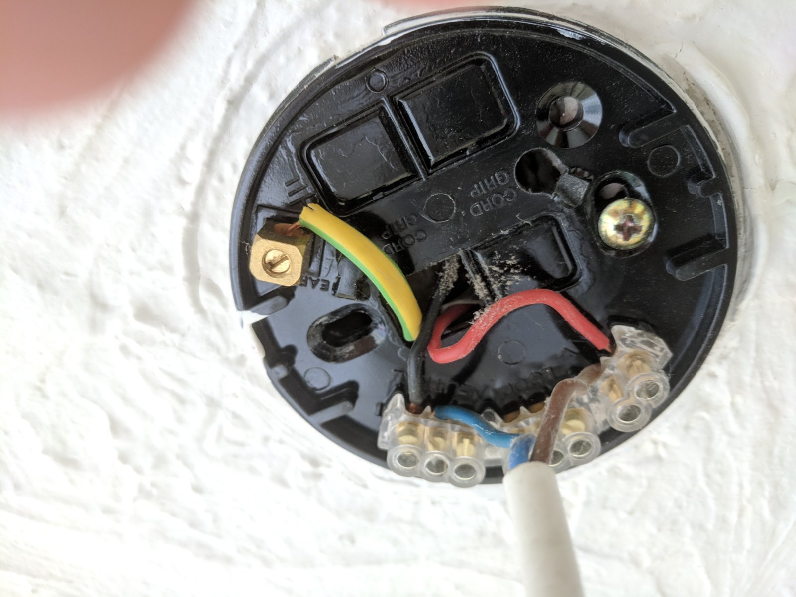

This is under the cover. Unless I'm missing something, there aren't hooks here?

That is because they have been broken, see where it says 'cord grip' and the broken edge?
Your options are fit a new ceiling rose, or botch it as suggested earlier by tightly fitting a tiewrap around the flex to take the weight.
Thanks - well spotted! So i'd wrap a cable tie around the brown and blue wires to help take the weight?
Any downsides with doing this? I think I'd struggle to replace the fitting myself, but just likely to be £40-ish to get a local electrician in...
