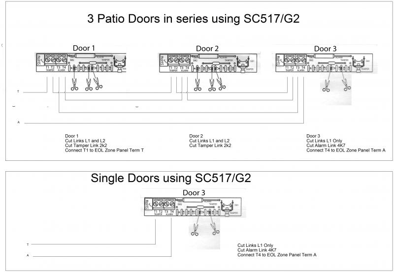

Picking back up on my previous thread //www.diynot.com/diy/threads/wiring-3-contacts-in-series-to-texecom-48.423284/ I have now purchased the SC517s ready to go.
I intend to use the FSL wiring option just want to be sure about the link cutting as the installation instruction shows for 2 sets of contact and I'm doing 3. Think twice and cut once all all that eh?.
Rather than try to explain in text I've put a drawing of how I think it should be wired in my albums-alarm. I'd appreciate if somebody could take a look and advise if it is correct, or suggest better/easier.
I'm also doing a single door, again hopefully got it right?
