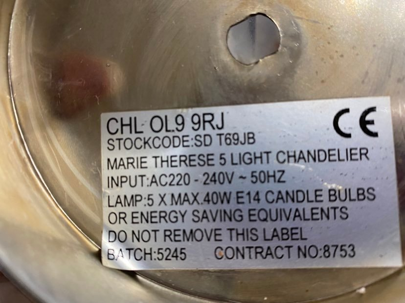

I'm repurposing a chandelier acquired from my mother and of course, she can't find the fitting instructions.
There are three wires on the chandelier - all of them clear.
Will there be a particular order that they connect up to ceiling wiring or does it not really matter
Look closer, there may be a thin coloured line running through each one.
If not, you will need a continuity tester/multimeter...
In answer to your other question - IT DOES MATTER WHICH WAY YOU WIRE THIS, so please check with us or a qualified electrician FIRST.

Don't worry, I won't be plugging myself into the National Grid. I don't see any coloured lines but I'll look again
One appears to have green running through, so perhaps that’s the earth? Any information from the writing? Is there a make/model sticker anywhere?
Hindsight is wonderful, but you could have taken a photo/made a note of the wiring before it was removed.
My mum got it taken down nearly two years ago and it's been sitting in a box since then and we never thought of asking the spark to take a picture. It's Litecraft and this is the info on it
  • Thanks
Reactions: CBW
The screw E14 bulb must have line centre and neutral outer in the UK, but easy enough with a meter or other means of belling out to work out which is connected to centre and which is connected to outer, a two minute job, but can't be done with pictures.
