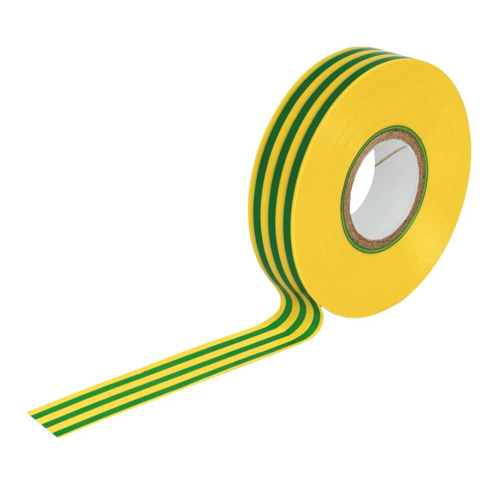

Thank everyone. I try not to trim the copper because it will make it shorter. Do you think insulating tape like below any good to replace the sellotape?
http://www.screwfix.com/p/insulating-tape-green-yellow-19mm-x-33m/77027

Sometimes the wires in the back box are a bit short.
What difference does it make?
He can wrap a bit of s.a.t. round it if he wants.
As someone pointed out earlier the flex neutral looks burnt up and does need cutting back as well as fitting the flex into the flex clamp.
The solid cores look doubled over, so shortening them and also doubling them over again, may make them a bit short and harder to connect.
Mk have tunnel terminals and they claim there is no need to double over anyway, so cutting a few mm off should not be a problem.
True, but the pic seems to suggest that there would be no problem in cutting off a few mm of the exposed cores - the terminal screws are even in unusually convenient places!
What difference does it make? He can wrap a bit of s.a.t. round it if he wants.
He can - but neither you nor I (nor many of the others around here) would do it, so does it necessarily make sense for him to be 'advised' to do it?
I also suspect that if the cables were so short that dealing with the terminations were a problem, that wrapping SAT around the cores might also be a bit of a mission!
