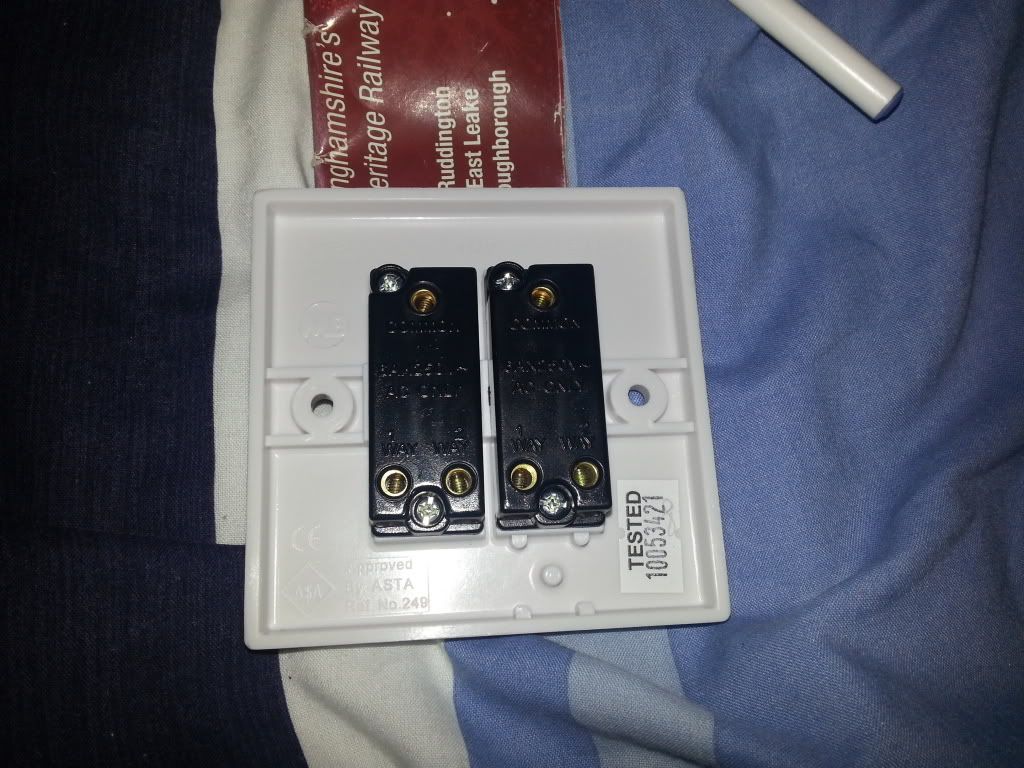

Hi everybody,
A google search for wiring diagrams pointed me in the direction of this site.
Basically in my garden, today I have fitted a flood lamp (with a sensor) which is Earthed.
Now to light another section of garden I need another light but not as powerful so bought a Double Insulated Single lamp.
Eventually these will be wired to the main lighting circuit in the garage by an electrician (we need some more electrical work doing in there hense requiring the electrician, around June 2013).
So as a temporary solution we want to do the following, but wire it to a 3 pin plug as a simple temporary soliton so we can see in our garden as we require access every night.

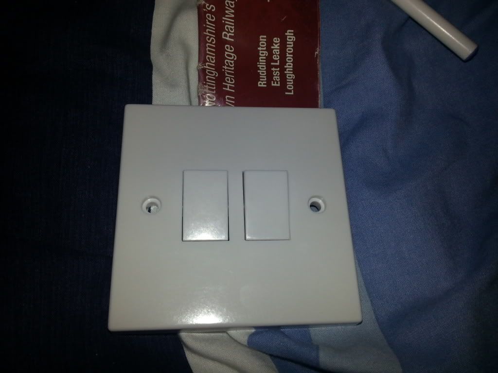

Please note I have purchased everything so all I need is some guidance to let me know what wires need to go where for the switch. I've already created the cable with the plug, and wired the 2 lights up, so its all relating to wiring of the double switch.
Any help would be most appreciated.
Thanks for that but I must be a total idiot because i'm still none the wiser.
Looking on my switch i've got 3 wire slots per switch. one at the top and 2 at the bottom.
The ones are the top are labeled "Common" and the bottom ones are "Way 1" & "Way 2".
I've got the usual wires to go in (one light is earthed and the other isnt), Earth Live & Neutral. I'm guessing i've got the incorrect switch so i'd need 4 slots on the back per switch wouldn't I?
Don't know if you have RCD protection, but would strongly advise you use a plug in 30 mA RCD or PowerBreaker between the socket and the plug. Also recommend a 3 or 5 amp fuse in the plug. Also urge you to check all connections you have also made are safe, also check everything outdoors is watertight, particularly round cable entries. Where possible, cables entering the accessory are more watertight at the bottom, with appropriate seals or glands.
At the switch, connect all earth wires to the earth terminal on the back box.
Connect all the neutrals to a separate 5 amp connector block, you may need to buy some.
Connect the supply live (from the plug) to one of the 'common' terminals. From here connect a short piece of brown wire to the other 'common' terminal.
Connect the live from light 1 to one of the terminals marked 1way.
Connect the live from light 2 to the remaining terminal marked 1way.
Leave the 2way terminals empty.
Send pictures of all your work - such an installation, though temporary, should be watertight and safe.

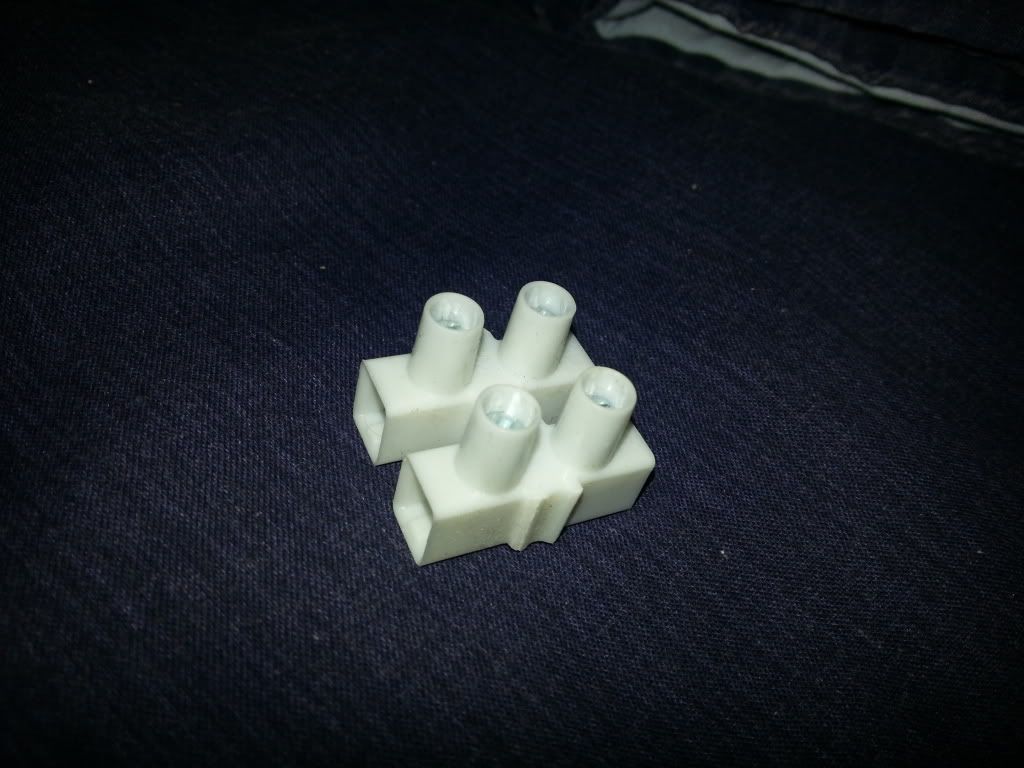

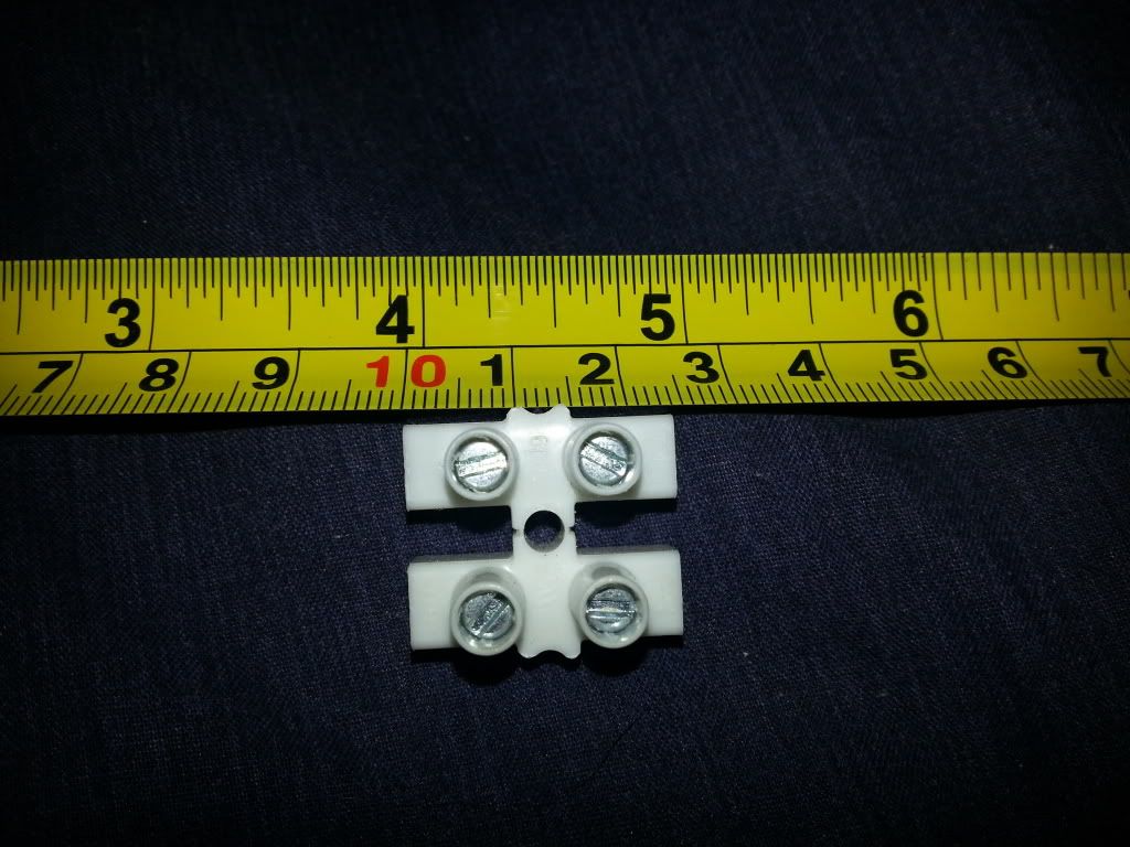

I already have some connector blocks, doesn't specify what AMP they are rated but states 600V? (not sure if sufficient).
Yes, that RCD is fine. As said, not sure what you have in the way of RCD protection, but will be safer to have that plug-in RCD.
Connector blocks come in 2,5,15,30,60 amp sizes generally. Send a picture and we may be able to tell you what they are.

Connector blocks look fine. IF they seem a bit big for the wires, double the ends of the wires over to give them a bit more 'strength'.
