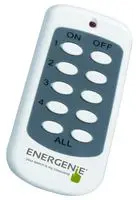

Bedrooms still use energenie as it has remote controls as well as the phone, so these Remote control.jpgon the bed side table work well, but Tapo also have push buttons, I use one as a door bell. It also logs it has been pressed.
Alexa I think does same as Nest Mini's but I am a cheap skate and the Mini's were cheaper. I tend to use the remote controls, my wife uses voice more.
