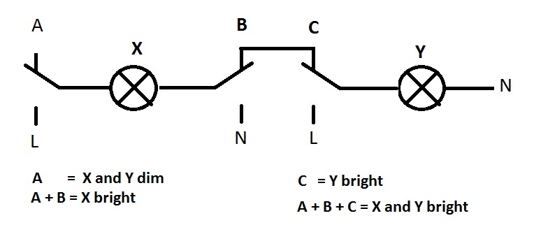

Having Live and Neutral on a single change over switch is not a good idea.
This is "my" circuit using either 3 change over switches ( direct on mains ) or relays operated by ELV switches or intelligent controller.
B and C can be combined in a two pole change over switch if it is not necessary to have X bright and Y off
Not ideal, I agree, but thats what b-b-m switches were made for, and why I stressed the need for one. However, I can't deny that your approach avoids that problem, and is therefore in that sence preferable. However, an issue with your arrangement, which could have safety implications, is finding a way of labelling the switches such as it would be clear to ('unfamiliar') users what they had to do to get the result they desired! In particular, in the absence of an overall on/off switch (which, admittedly, could be added) it might not necessarily be obvious to everyone what they had to do to render a particular lamp holder 'safe' (i.e. no L feed to it).
Specifically, it is more than a little worrying that switch B switches the neutral to lamp X. That means that if switch A is 'on', then lamp X can be switched off with switch B, but leaving a live feed to lamp X. I'd need to think about it, but such 'neutral switching' might (at LV) even be non-compliant with the regs. If it were a simple' lighting set-up, I certainly wouldn't be happy with a switch in the neutral, even if there was also a (separate) switch in the L, would you?
Indeed - although labelling (hence potentially safety) remains a bit of a problem. However, as I said before, if (unlike you) we are talking LV, then I don't think you would be able to find a 2p2w switch as an 'electrical accessory'.

Interesting point, and (although I'd have to look and think), that might be non-compliant with the regs. Similarly, as I've just written, I'm not all that happy (and not convinced about reg-compliance) of bernard's approach of having a switch in the neutral to one of the lamps which can be operated independently of the switch in the L supply to the same lamp.
Kind Regards, John
having a switch (B) in the neutral to one of the lamps which can be operated independently of the switch (A) in the L supply to the same lamp (X) .
It doesn't matter which way switch B is when A is closed. The "neutral" side of lamp X is connected to Neutral either directly or via the other lamp. OK the voltage on the Neutral of X could be 115 which is not normal for a neutral but as regulations seem to allow for open circuit Neutrals becoming live via a lamp or appliance ( treat Neutrals as live conductors ) then they should allow a "Neutral" to be semi-live at 115 volts when the lamps are dimmed and live at 230 volts when they should be dimmed but lamp Y has blown or is missing.
What if light Y's Neutral was connected directly to N at switch B?
Would you still be concerned?
Edited 'cos I spelt Y wrong. :whistle:

If these are potentially make-before-break switches and if B-C is a single switch, then you can have a L-N short while switching through both switches.
As yet I have not come across a standard main light switch that was make before break. My experience is that they are all break before make and the air gap from L1 to L2 via the faces of the moving contact is never less than 3 mm even when the switch is changing state. ( But I could be wrong due to in-experience )
I once came across a house where Live and Neutral were looped at the all the switches with Neutral and Switched Live going up the switch drop to the lamp. Two way switching was to have Live on L1 and Neutral on L2 at both switches and the Commons wired to either side of the lamp. Problems only occured with the inductive load of the two way switched flourescent lamp in the kitchen after the original tumbler switches were replaced with modern rockers. The breaking arc ( Lx to Common ) continued until the moving contact reached the other L and the arc was then between Live and Nuetral and a few times had maintained itself until the switch fell apart with smoke and flames.
What you say would surely not be true if, as per you diagram, switches B and C were independent (rather than being 'linked', as in a 2p2w). Unless I'm missing something, with the circuit per your diagram (switches B & C separate), with A 'down' ('on'), B 'up' and C 'down', lamp X would not be lit, but at least one side of it (both sides if the lamp were intact) of it would be at L potential - which is surely a potentially hazardous situation?
Kind Regards, John
