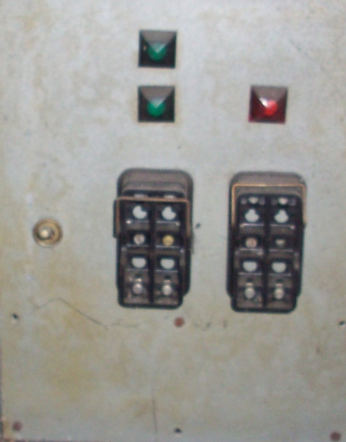

We just didn't think much about safety back then, even though we had the knowledge, had we been bothered to apply it. Back in the 60s I built countless power supplies (or power supplies as part of other equipment), part of the front panel invariably looked something like this (apologies for ancient photo!):
Those are two Bulgin dual fuse holders. The one on the right, under the (wonky!) red neon will have held fuses in both L and N of the incoming supply (the two fuses in the LH holder would have been for outputs, each with its green neon). That was totally 'standard' in those days, and it was only decades later that the hazard of having a fuse in the neutral even occurred to me!
