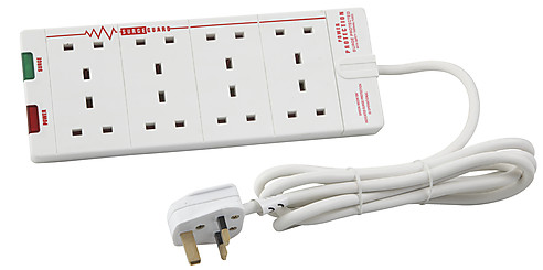

Justin,
With regards to wanting written evidence - Are you overthinking this?
You have a 13A fuse, 2.5mm2 cable, and 8 sockets.
Your setup is the same setup as this (in fact yours is better as you have better cables, and sockets). :
The 13A fuse in the plug/FCU will protect the 2.5mm2 cable, whatever order or number or connection of the subsequent sockets.
Your circuit is correct and the 13A fuse will protect the cable.
I actually used that exact same comparison with him right at the beginning, before he convinced me to rewire everything in a line, but he didn't accept it was the same thing or met regulations.
