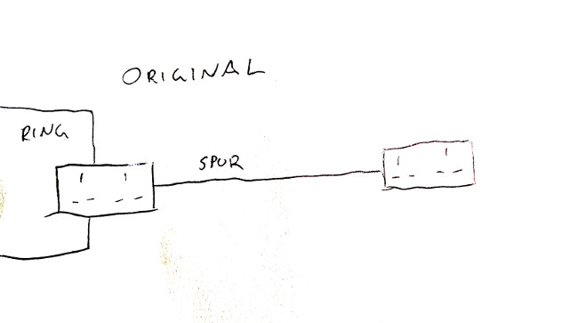

My house was built last year and came with a double socket in the garage, on a spur connected through the wall to the kitchen (see "original" below).
I wanted to add more sockets to the garage for convenience, but don't need any extra power, so I'm limiting the whole garage to 13A through an FCU (originally I had a breaker as per an earlier post, but the electrician didn't like it so I went for the more standard FCU).
I've added 7 sockets (I know its a lot, but they're in convenient places) but I've only drawn 4 in the diagrams for simplicity. All wiring, including before/after FCU, is 2.5mm T&E.
I had an electrician look at what I've done. However he did not like how I had wired up the sockets, see "attempt #1" below, which was using multiple junction boxes branching off in a non-radial arrangement. I believed that the 13A FCU meant I could wire it up however I like, but he said it had to be radial.
So I went for "attempt #2" below, which is fully radial. The whole length of the spur is as a result almost 30m, which means I think I could see up to 7V voltage drop based on 2.5mm T&E ratings (0.018 x 13A x 30m = 7V). But that should be within limits, I think.
However, the electrician now says he is concerned that because "the fused spur is fed radial from a socket & not wired directly to form part of the ring final" then "the load at the first part of the circuit from skt to spur could exceed the rating of the cable supplying it", and he needs to go and do some calculations.
This seems really odd to me. The load to the FCU will be the same as the load after it, right? And a single spur with double socket or FCU off one point in the ring is totally standard, isn't it?

1) No.
2) There isn't a problem. It is protected by the 13A fuse.
Your attempt #1 IS a radial. Although I agree about the JBs. You could have wired from socket to socket.

Not so. As I said, It is protected by the 13A fuse so cannot be overloaded. It is, after all, the same size as the cable after the FCU.
3) How can it make any difference whether the FCU is on the ring final or on the radial spur? Because he seems to be saying that the cable between the spur point on the ring and the feed to the FCU will be under higher load than the cable on the load side of the FCU. But that to me seems to contradict basic electronics for a series circuit - what am I missing here?
Nothing. You are correct. It is obvious isn't it?
Anyway, 2.5mm² cable (assuming it is that) can carry 27A. A 13A fuse cannot.

No, as has been said, what you have is a 'radial with branches', which is still a radial circuit.
The only common alternative to a radial circuit is a 'ring (final) circuit' and that is an (unbranching) radial with a second connection back to the CU from the final socket in the run. Any branches from a ring final are called 'spurs' (which can be fused, like yours, or unfused - but the latter can generally only supply one socket).
