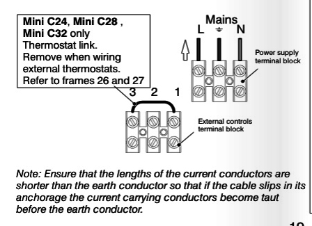

Wiring new boiler thermostat
I am a cheap skate, I would find the smallest tungsten bulb I could find, and wire it between first grey black then grey brown with the old thermostat connected and turn the dial up/down.
What I would hope is one would stay lit what ever you did that would be supply, the other would go on/off that is return, if light does not go on/off with either or on with either then the grey is not connected to neutral.
What we are doing is generating a truth table.
The new picture says you must use volt free, so it needs at least 5 core cable and you only have three core, so it is a case of running either a 5 core or a second cable.
I had wrong manual try this one so the 5 wires shown are:
L = 4
N = 3
1 = 1
2 = 2
Earth not used.
I think that they cut the neutral way before, because actually I'm missing the blue one, as I'm not able then I will call an electrician.
Do you know somebody near Bishop's Stortford area that is not expensive?
Thank you very much for your help anyway
