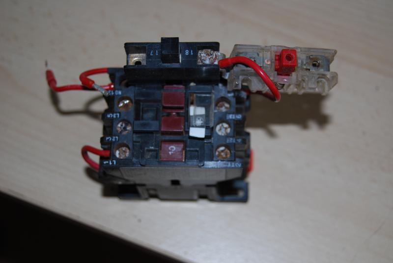

i have a large old dewalt planer thicknesser type dw1150, which is a 240volt model. The incoming wiring goes through an industrial type on off switch box, with a large red stop button. from there it goes to a small box that has a condensor in it. When i bought it the old boy said it needed a new condensor.
When i opened it up to replace the condensor (which ive done) i found there were some wires that were unconnected in the switch gear housing. Having managed to get some photos from someone else with a working one, ive wired it all up as it should be. When i power it up i get a hum from but nothing else. (also stops humming if i press the off switch!) the motor turns freely by hand.

i by passed the switch and it works fine. having looked at the switch wiring connections, they all appear to be rusty and to have seen better days, so now i know it works, ill order a replacement.
many thanks
ok next question. Im looking to replace the switching unit, but a bit confused with what i need.

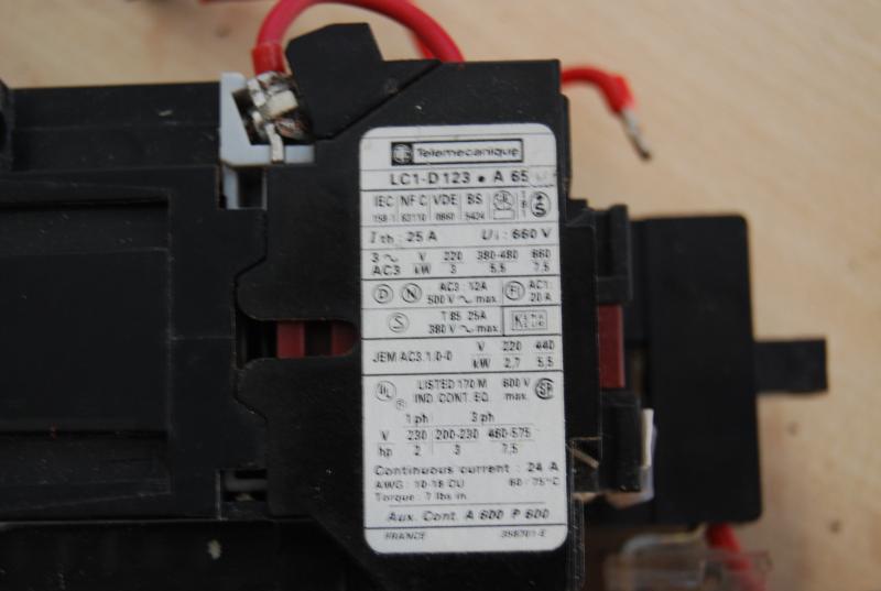

the original is here and it may as well be written in greek!
That is just a straightforward DOL starter with no overload. There are two aux. contacts, one for start and one for stop. The orientation will need to be maintained for the pushbuttons to reach the contacts.
How do you know that this one has failed ?
