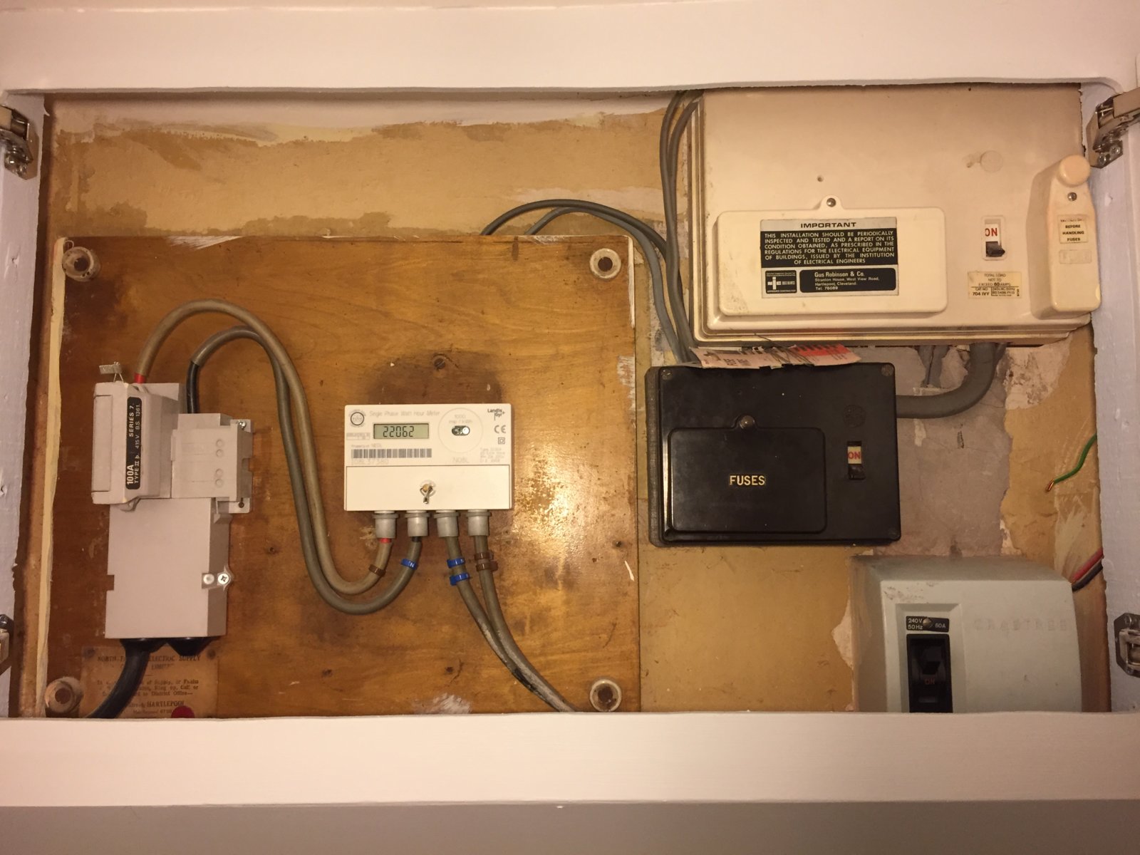

My main circuit breaker tripped today when I switched the mains switch on to the oven.
I took the switch off and bypassed it to check if the switch was knackered and it tripped again. I then bypassed the wiring from the switch to the oven, and the oven worked ok, so I'm guessing the wiring from the oven mains switch to the oven itself is knackered ??
Although not an electrician, but comfortable with electrics and multimeters, is there any way I can test the wire ?? I checked the continuity and got a tone from the multimeter on both the live and negative, but not when I crossed the wires live to negative. Unfortunately, that's where my skill levels ran out :(.

The big, big switch straight after the electricity board side, I.e. - the main circuit breaker that switches off everything in the house.
I'm guessing RCd, any chance of a photo? Does it say 30mA on it anywhere?
Is the offending cable damp or filthy anywhere? Has any work been done on the wall isit buried in?
Here’s a couple of pics.
Oven fuse is on the board on the top right, the switch that tripped is bottom right, and there’s a close up for good measure :-)

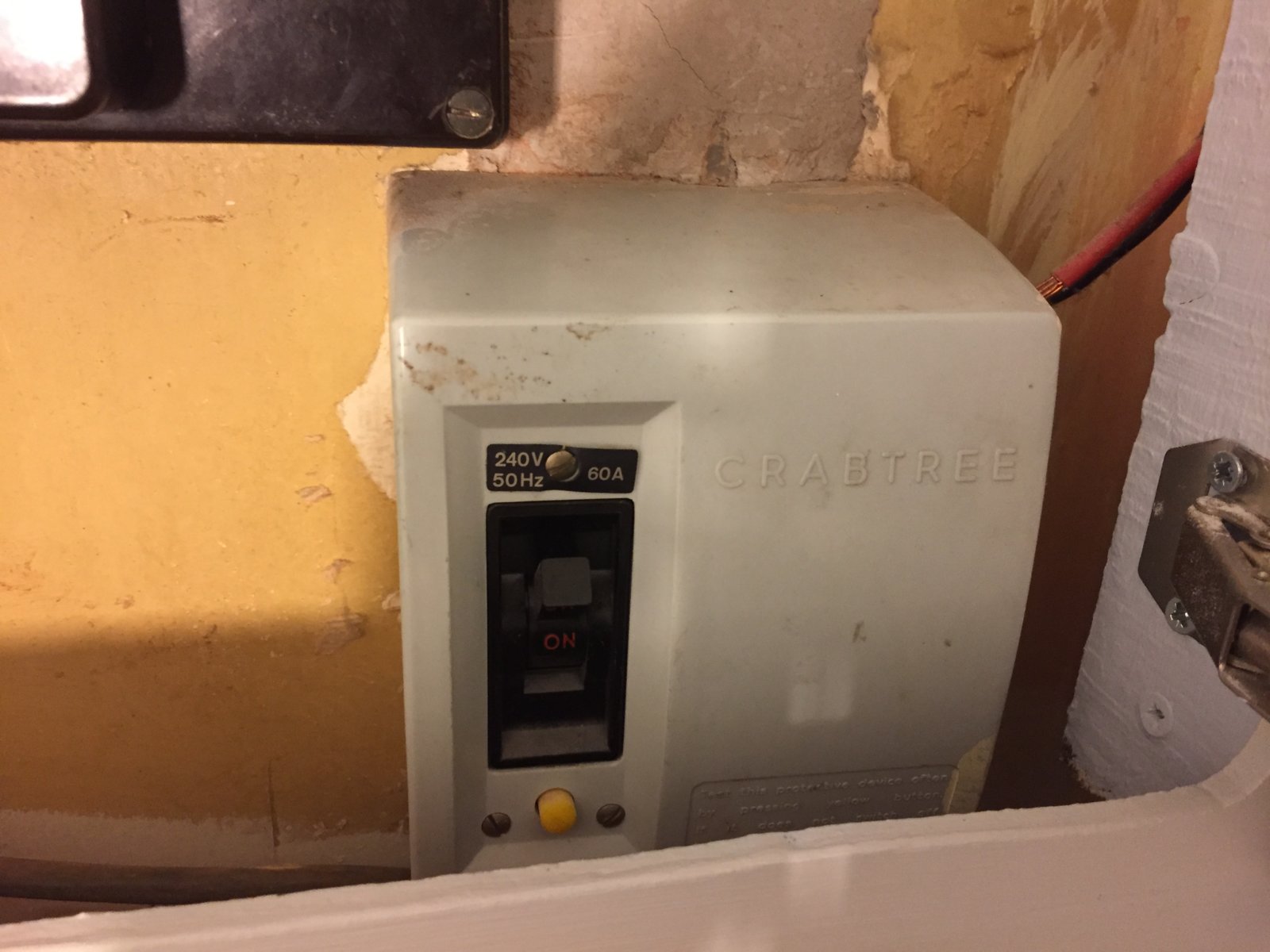

yes, looks like the rcd

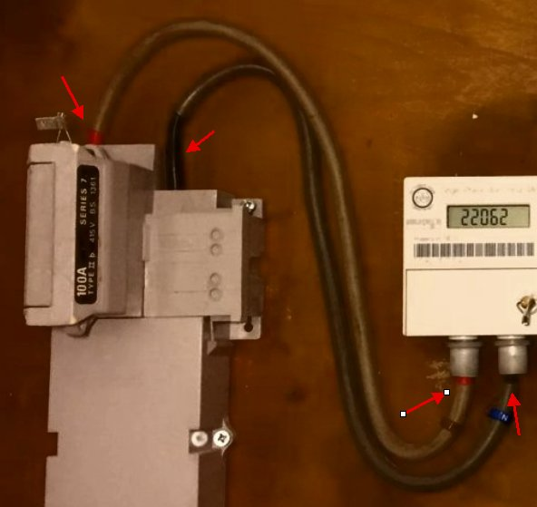

None of the red and black inner insulations of those cables should not be exposed and visible outside of the enclosures they go into. One sometimes sees tiny glimpses of a little red/black, but that black one on the left (where it comes out of their service fuse) is particularly ridiculous - and none of them is really acceptable.
Kind Regards, John
Edit: another crucial typo corrected - my apologies
I wouldn’t wait a couple of weeks.
The old VoELCB needs replacement. The earthing needs sorting out, and there’s a potential of a line/neutral reversal.
Get yourself an electrician to look at all of that. He can resolve your suspect faulty cable at the same time.
PS the earth will probably be at the VoELCB. And probably connected to an earth rod outside the house, somewhere. It’s worth finding if your supply can be converted to what is known as TNC-S.
Isn't that a VOELCB, and as such, long overdue for replacement?
It looks as if it could well be. It looks as if there's some writing down in the bottom right of the cover, which I can't read - and we really need to know what it says.
