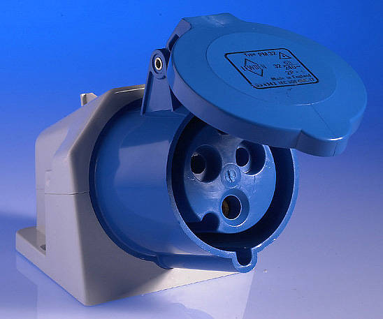

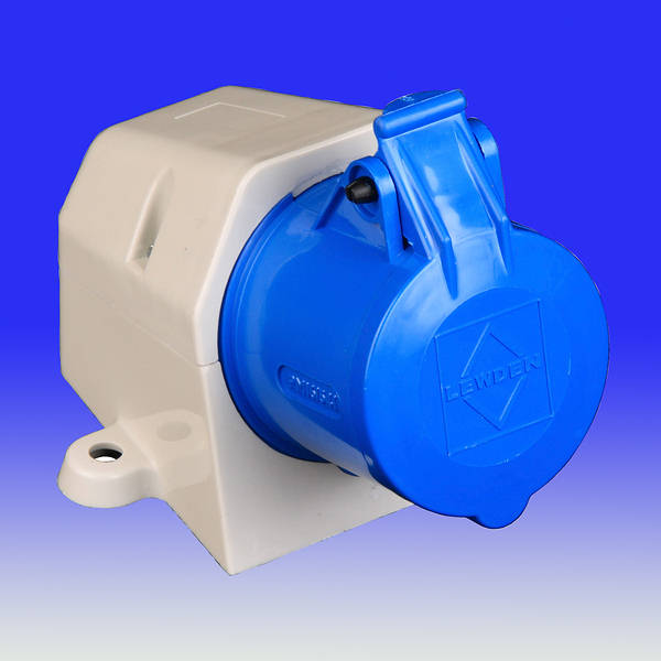

BAS i really don't see the need for 32A sockets in a domestic environment
after all even if you used one you couldn't plug your washing machine in anywhere else anyway

Plug
