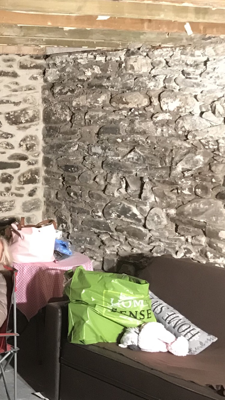

    I’ve only ever done wiring in modern houses with trunking etc and plaster board over. We’re renovating an old stone wall cottage. The idea is to have the ground floor stone exposed for aesthetics and keeping the place naturally dry. I want to fit some electrical sockets to each wall but I’m not sure what surface trunking is required and whether it can come up from the floor or down from the ceiling. I’ll be using a qualified electrician, however, the last QE I used didn’t seem to be the full ticket. If I know how it should be I can keep my eye on the proceedings and advise accordingly. It would be good if there was some decorative trunking available as it’s going to be exposed.

    It’s just the walls down stairs as I can do the uppers in the stud walls and conceal the wires.

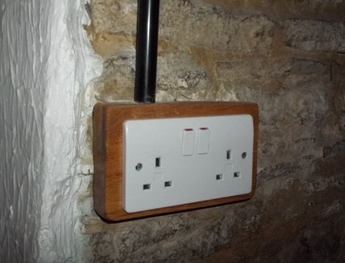

    But, it could so long as it was really obviously feeding a socket and not being a pipe but you wouldn’t get 2x2.5 down a 15mm pipe so you’d need a 22 which is obviously bigger than 20mm conduit.
    On top of that, you would struggle like crap to make the tube off into the socket. And you’d need to Earth it
    You’re much better off using MICC/Pyro as it will look almost exactly the same, but it’s minuscule in comparison.

    Black 20 mm conduit isn't too out of place on an old stone wall
