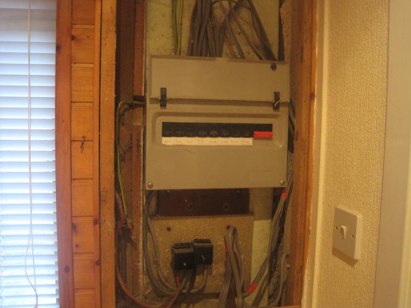

Hi,
I am trying to connect up 3 Storage heaters(1 med size and 2 small) in a small cottage. I have run seperate cables to each and intend to connect them up to their own small consumer unit.
The meter for the cottage is in a neighbouring house, it is just the main consumer unit that is in the cottage. There is a spare in the main consumer unit.
Is it possible(sensible?) to connect up the new storage heater consumer unit to the existing consumer unit.
If this is how I should do it should I also get the existing electric meter changed for an Economy 7 meter?
Any advice would be much appreciated

That's my problem, I cannot get cable run from the proposed Storage Heating Consumer unit to the meter, that is why I was asking if it was possible to connect it up to the main Consumer Unit (the one in the pic)
It is likely the total load of the storage heaters would exceed the maximum possible on one way of the consumer unit.
Storage heaters usually use 20A radial circuits so 4 x 20A = 80A.

Is it possible to replace the main consumer unit with one that would do the 3 storage heaters (1 med size and 2x smallest size) and the normal household circuits?

Do you have a main isolator fuse in the building?or is it in the other property? If yes to the first question, what size is it? You could fit Henley Blocks and feed the two consumer units from these.
