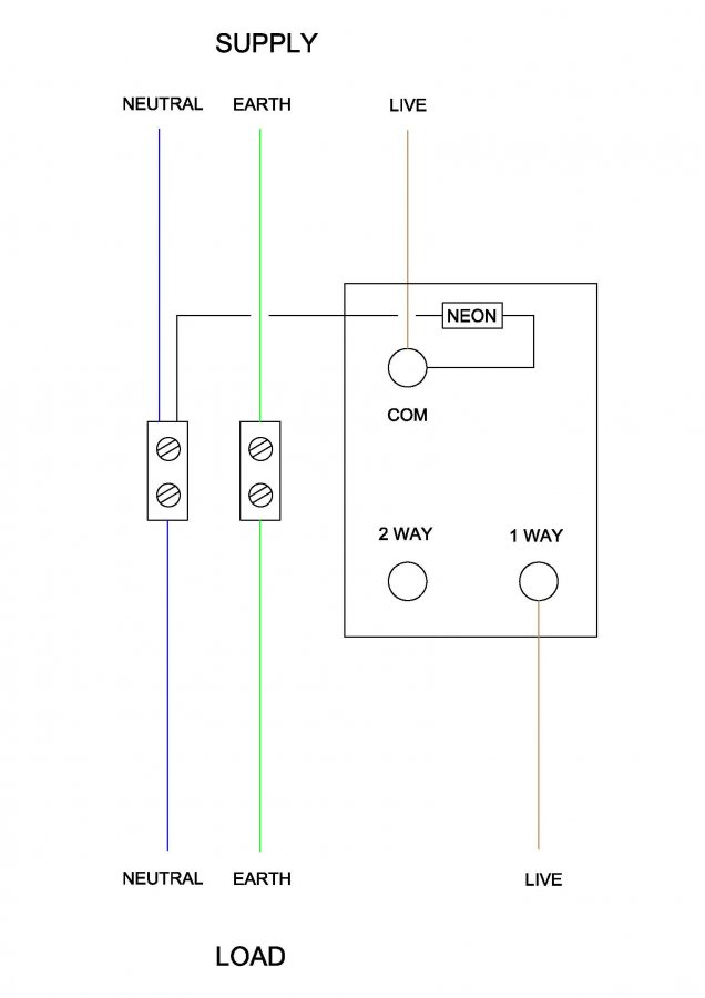

    hi
    ive attached two pics which show the actual switch and the bumph with it. out of the 3 choices of wiring, id prefer the 'power mode', so that the neon is lit only when theres power to the unit, whether its switched on or not. more of a reminder to me that ive left the power on to outside, so knock it off at consumer. no real need to, but we'd rarely use the external power so id be happier switching off for a month or two at a time, or over winter.
    id like to okay it first here before going ahead with anything :)
    [​IMG]
    [​IMG]
    bumph tells me for what i want to do, 'discard link wire and connect neutral to terminal block'.
    now, a normal switch without neon, i assume is live in to com, live out to L1 (or 1 way), neutral in and out connected to separate terminal block stuffed in the switch, and earth in and out connected to the terminal in the backplate yes?
    with my instructions, i now have to 'connect neutral to terminal block'. its unclear to me which neutral, and how exactly i do this.
    i assume live in and out are as i mentioned before, into com, out of L1.
    i remove link wire, i now have bottom end of that neon terminal spare. so do i put the incoming neutral into that terminal? and if so where does outgoing neutral go? same terminal? so both neutrals in same end of a terminal? doesnt seem right to me.
    could someone explain in simple terms exactly what i need to connect where please?
    thanks a lot
    EDIT: this will be a single switch supplying 2 external lights, so when switched, both lights will come on.

    It depends upon what wires you have at the switch. For the neon to be lit permanently whenever the power is on at the consumer unit supplying it, regardless of the position of the switch, then you need a neutral present. If there is one, it would be wired like this:
    If there isn't a neutral present, then you can only have it configured in 'Locator Mode' which means that the neon will ONLY ONLY BE ON when the switch is OFF, and would be wired like this.
    In the above diagram I have only shown one earth wire connected to the switch's earth terminal, as it is usual to have a single cable with two cores and an earth used in this configuration. If you have more than one earth, then connect them all to it.

    yep, i have flat twin and earth, so diagram 1 is the one i need. thanks a lot for that, much appreciated.

    Both diagrams could have 'flat twin and earth'. Diagram 1 would have two twin & earth cables. Diagram 2 has just one.
