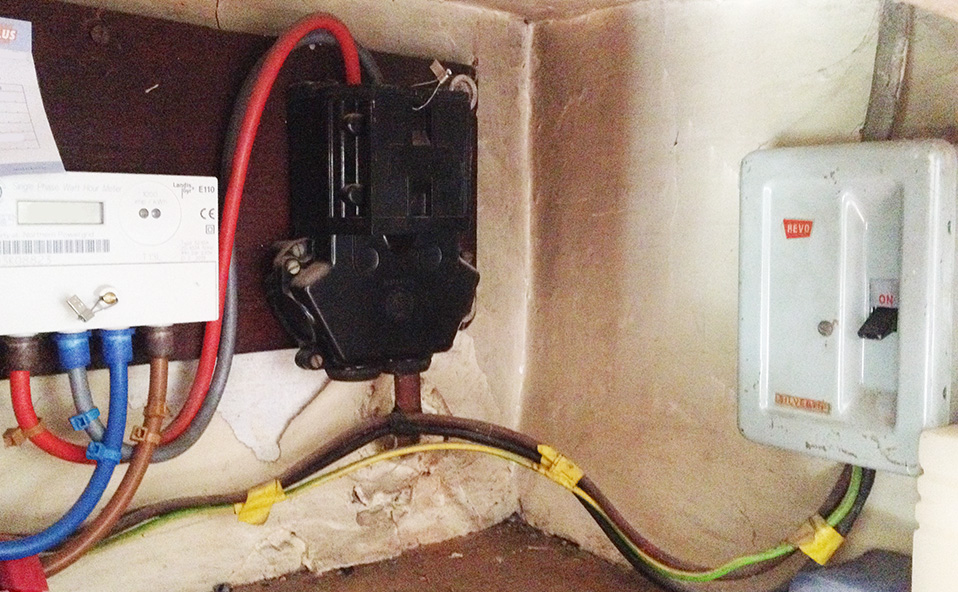

Afternoon all
Need some advice please.

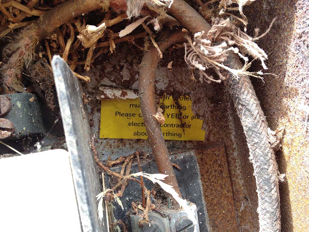

I've recently noticed I don't appear to have an earth attached for my CU, so after reading up, thought I'd contact the electric supply folk, who have offered to give me a PME (subject to visit) for £157.
There is a yellow sticker and talking about earthing, but can't make it all out.

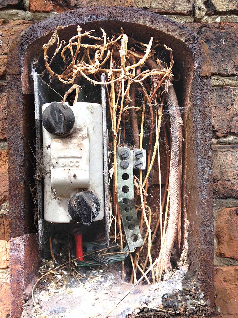

This also got me following cables around (as I'm nosey), and found some things I don't like the look of!

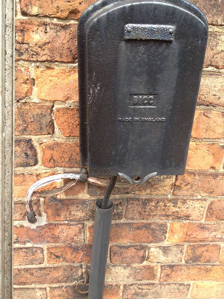

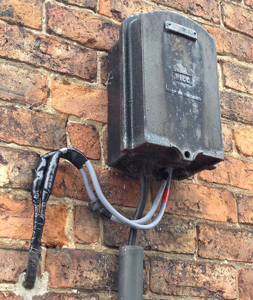

I have attached some images, the supply looks like it's more modern, then goes in the black box of doom, from there it all looks like it's gone wrong! you'll see what I mean, when you see the images.
The braided cable covering look shocking!
So my question is... do I have an earth?
Should I get the supply guys to fit PME? (if they can).
Will they supply new incoming cable to internals?
Or would an electrician be able to sort all this out?
The earth cable you can see on the last image, is going from the old cooker switch to CU.

The label suggests it's already connected to a PME network, so you should be able to obtain a TN-C-S supply if you wish. Are you certain the property hasn't been configured for a TT supply?
The cable to the service head is not ideal, but the DNO are unlikely to replace unless it's immediately dangerous.
No electrician can do anything with that - it all belongs to the DNO.
One option might be to have an external meter box fitted where that cast iron box is, and have the meter and cutout moved there, rather than having them inside.
No, but in the unlikely event of a fault causing one to blow, it would (probably) be pot luck which one it was.
Those BICC burpacks are usually mounted at high level and not meant for any top dick or harry to open! I couldn't want to be removing that cover without the appropriate kit!
Yes that outside box is a hazard as it gives open access to live un fused parts. We had our cutout replaced for free for far less danger than that. Ours was metal and didn't meet ip ratings, but yours is actually dangerous.
Call your dno and send them those photos and they'll be out pretty soon to change it.
Regarding the earth, it doesn't look they have provided an earthing terminal, but you can ask them at the dno. If they say it's TT then you need an electrician to fit a rod but it appears like you should have pme if you want it.

Out of curiosity, will the DNO charge for replacing the braided bit?
Should be free, they own the equipment before the meter so unless you damaged it they are fully responsible for maintaining it.
