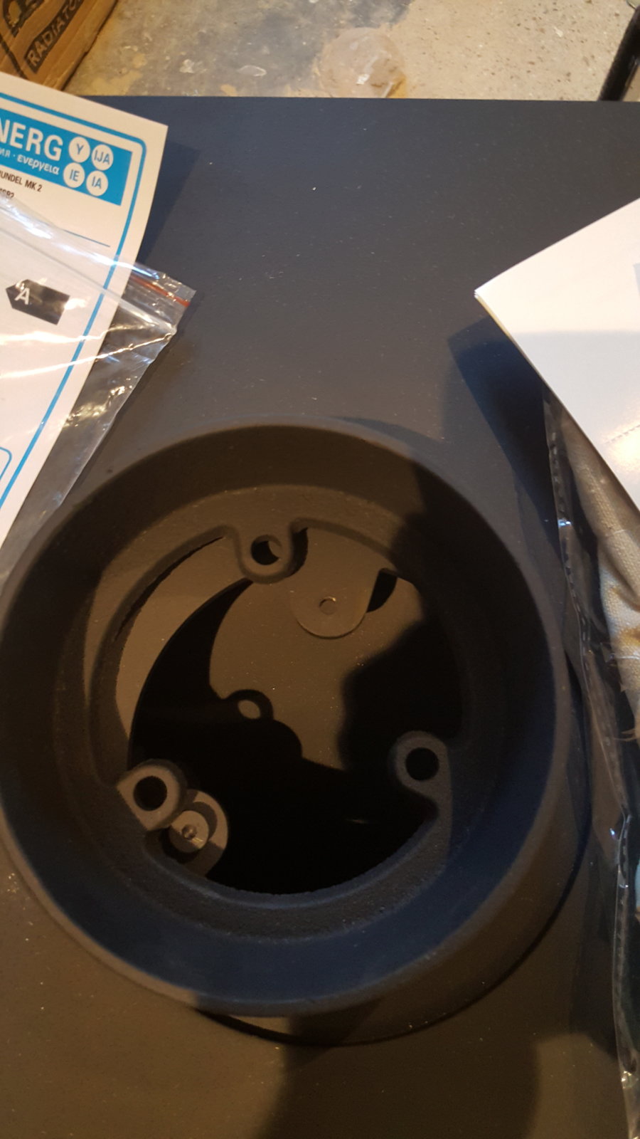

I'm installing a wood burning stove and the collar is attached by three screws inside it. The question I have is how can screw the collar in if I'm fitting the stove pipe to the adapter poking out of the closure plate, slipping the collar on to the pipe and then sliding the stove into position. How can I access the internal screws if the pipe is fitted before the stove is positioned underneath?
The pipe I have is vitreous pipe and has to be cut to size. Do I have to screw the collar in as I'm going to be dealing with due cement anyway?

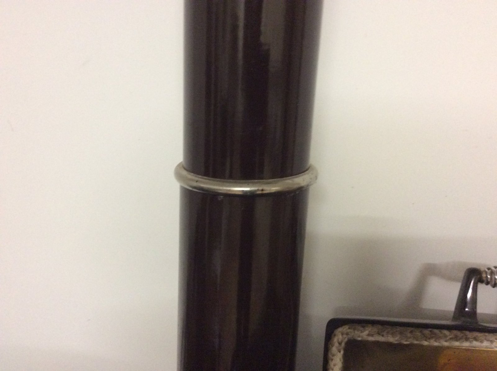

I have vitrius adjustable length on my range, the joint is dry sealed with a locking band flue cement cracks
Would there be an issue in screwing the collar to the stove from underneath by removing the throat plate temporarily?

Thanks for all the responses. I managed to remove the throat plate and screw the collar to the stove from underneath. All sealed up and drying ready for first small burn tomorrow.
