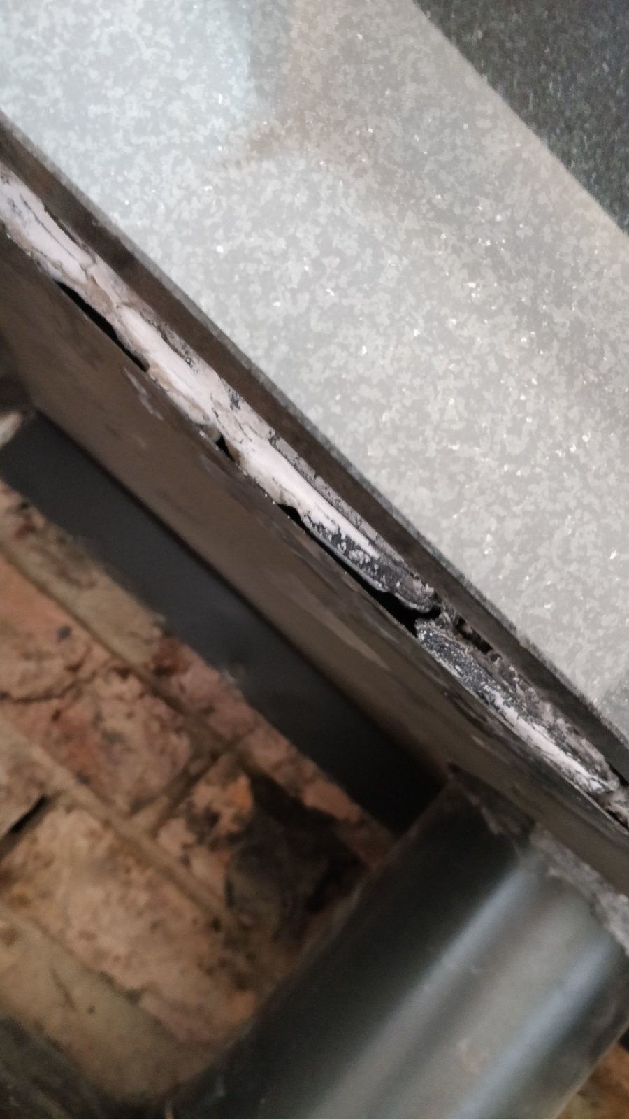

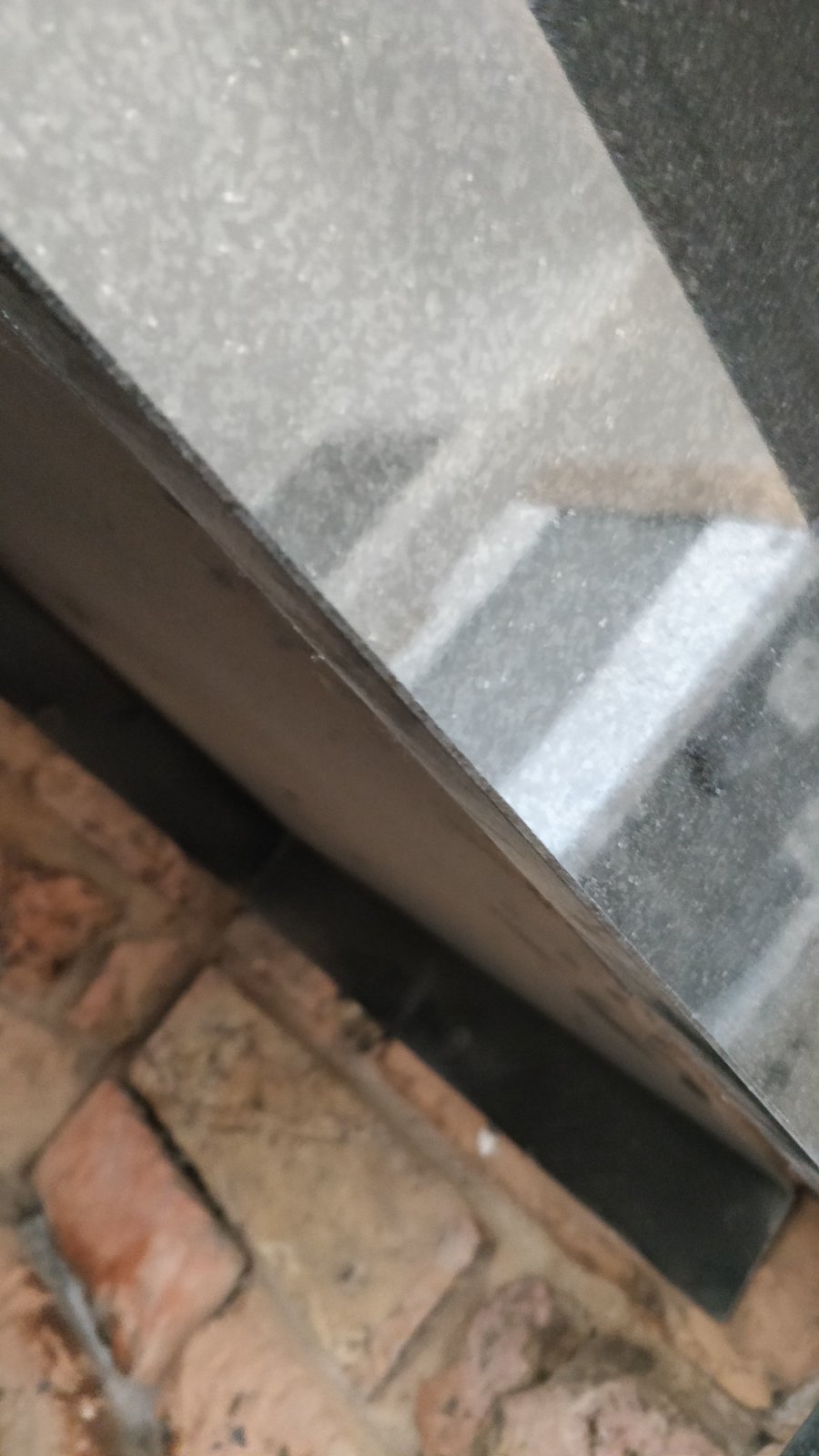

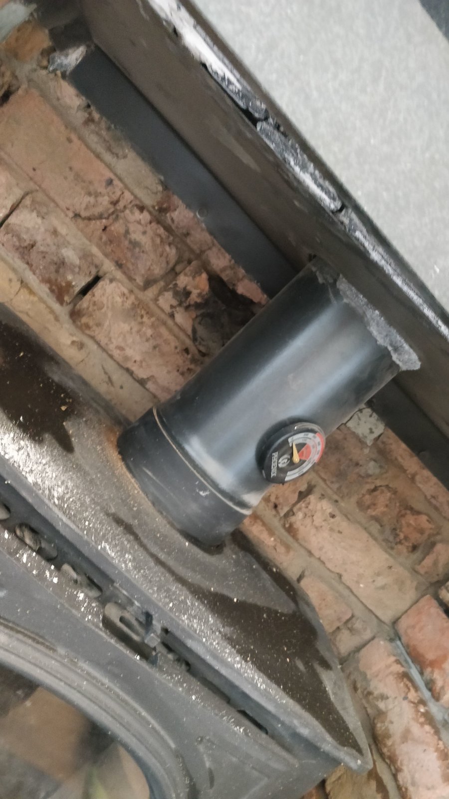

Hello,
As I was cleaning my wood burning stove, which I had installed last year, I have noticed that the black panel above it is loose and ashes are coming down from the chimney.
Any feedback? Many thanks

That's the register plate - it's either rusted through or the sealant has died.
Get some stove grout stuff in there, then paint accordingly. If your chimney is lined, there shouldn't be any smoke coming through the hole
Nozzle
Thank you. I have used this stove only 5 or 6 times. Do you know why this may have happened so fast?
On second look - it appears as though that left side of the register plaet has dropped down, exposing the fibre or grout. Can you see any screws there to tighten that left side back up? It might be the fittings have pulled out of whatever they're screwed in to.
Nozzle
It doesn’t look like the register plate is secured at the front at all :eek:
I’d rake that grout ( grot) out and see if the plate will lift up.
John :)
Yes, I can see some screws on each side of the register plate but nothing in the front.
I can lift the plate up and when it comes down again, ashes come out.
Thanks for your advice guys!

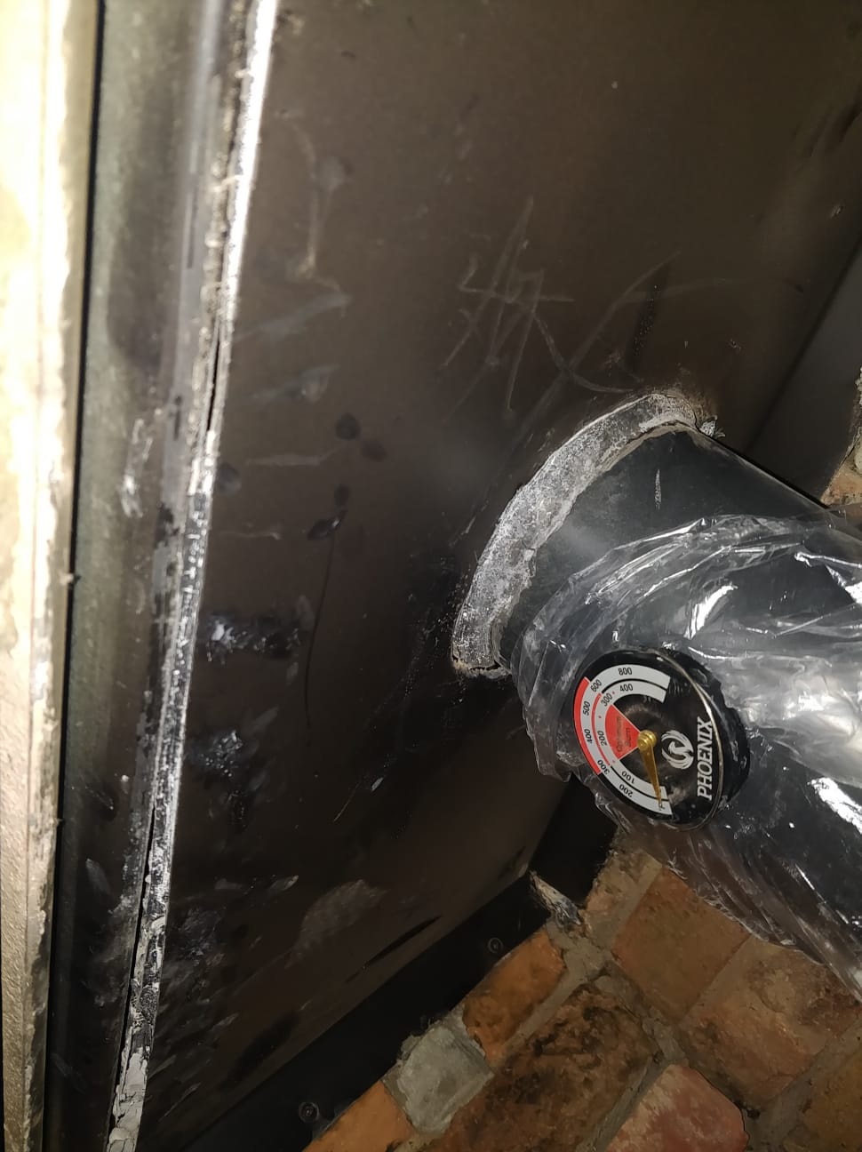

OP,
Remove the wrapping from the pipe.
When did the moisture first appear?
If you intend to DIY this then remove the screws you can see in the plate lip.
Then cut the silicon blobbed thats blobbed on.
Then lower the plate.
Then take a looking up pic & post it on here.
It doesn’t look like its ever been fixed at the front, Benny.......just the back and sides to some degree.
It also looks like 1.5mm steel sheet which is hardly self supporting - I make them from 3mm steel which wouldn’t flop like that.
John :)
it seems either the brickwork or marble aren’t level. leaving a large gap front left. tbh it doesn’t look like a professional install. the brickwork isn’t even level or tied in the corners , looks like a steel fire, not cast and the fire cement around the pipe to plate is poor too.
