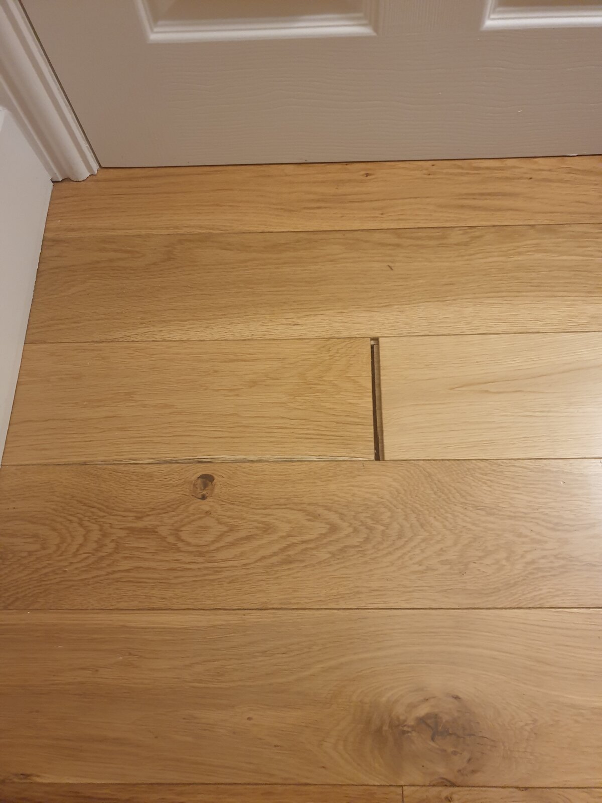

Had this oak floor a few years now. Really happy with it. About a year after fitting this gap appeared.
What would you do? Filler? Wood to infill? Leave it alone?
I wouldn't be that bothered it's just right in front of a door...

You may be able to nudge it to fill the gap if there is enough under the skirting board to the left. Or maybe from the other side depending what's there
yes looks like a "loose plank" so you need to "work " back into position with grippy shoes or other method then work out a way to secure in position assuming it moves again
Not sure about that. I saw him doing it. Each plank was nailed to the floorboards I'm fairly sure, will the planks move easily? .. He seemed to use a special nailer.
He might have forgotten or not bothered nailing the last short plank. Give it a kick with your trainers on and see if it moves. If it does kick it back open, put some wood glue in the joint and kick it shut.
Thanks. Had a good kick, not budging. Any other idea ? Filler seems unsophisticated!

The board is definitely not for moving and I've messaged the guy who fitted this a few years ago, but no reply.
How would you approach it, is it DIYable or something a joiner could make look a bit better?

Because all edges are chamfered its going to be difficult to get the Ballance right
try using medium oak coloured filler as slightly darker would look less in your face
as the edge is chamfered the joint is in a "V" shape
try increasing to form a slightly shallower angle this may help disguise the greater width and slightly deeper v groove
I'm not a floorer, but I'd have my multitool out, cut a little square out of the bottom of the skirting to hook one of those flooring tools over the end of the board and hammer it back, make good skirting.
Whats to the right of the photo? That board may move left.
