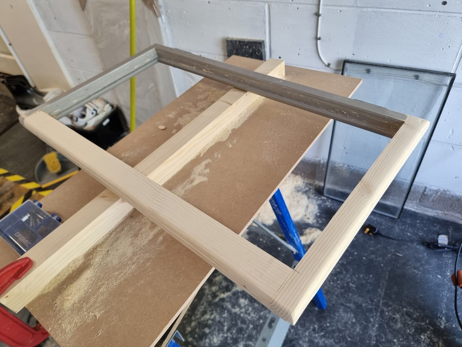

I had a crazy idea. I think I can probably make the bottom and side pieces and I am probably not going to mess about with trying to fill it.
I borrowed my dads router and bits and had a go at making some profile bits and I reckon I can do this, even the joins.
The only bit I'm really worries about is removing the glass. I already have two bits of beading removed, I think with the other two it should come out.
I've drawn the cross-sections on paper and so... what could possibly go wrong? Obviously there are infinite ways it can go wrong and only a couple where it goes right - but to be honest its a while since I did something like this.

If you have a chisel, saw and router, you should be able to make a new sash fairly easily.
I mad a replacement sliding Yorkshire window years ago, with little more than above... oh used a couple of ratchet straps whilst the glue set.
You might find it easier to remake than repair.
Can you take a pic of the back of window
That is exactly what I did.
I really enjoyed myself, but it was a lot of effort.

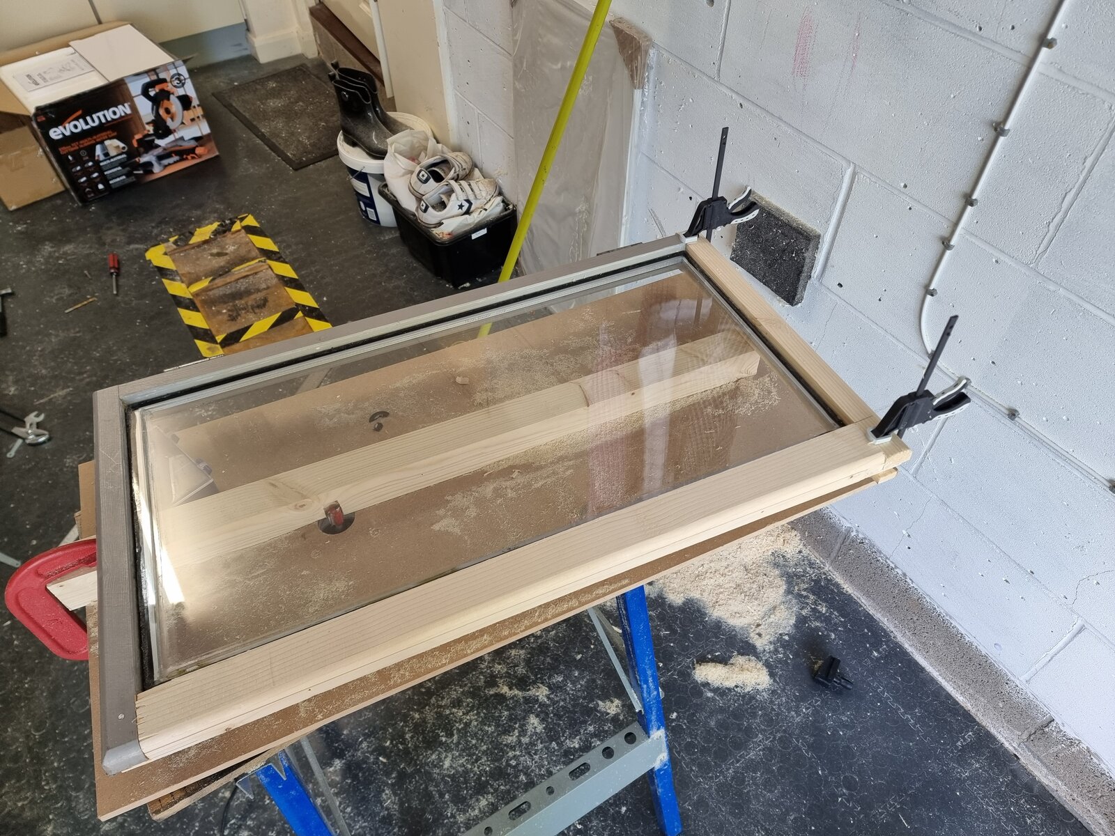

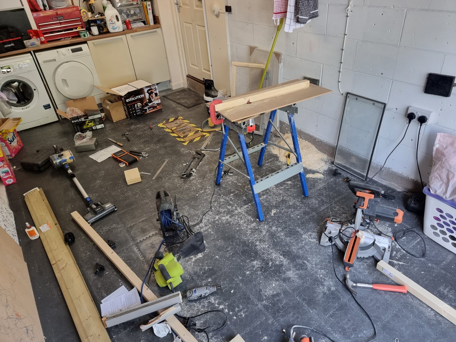

I did make a huge mess of the place. Pretty much took all day. If I charged for my time I can see the repair would be too expensive
The end result before I put the trim back in. You can't tell its been repaired other than it now looks better than the rest if the building which will need painting.
I sealed the hell out of it and will remember to check it every year.
I'm pleased with the result.
