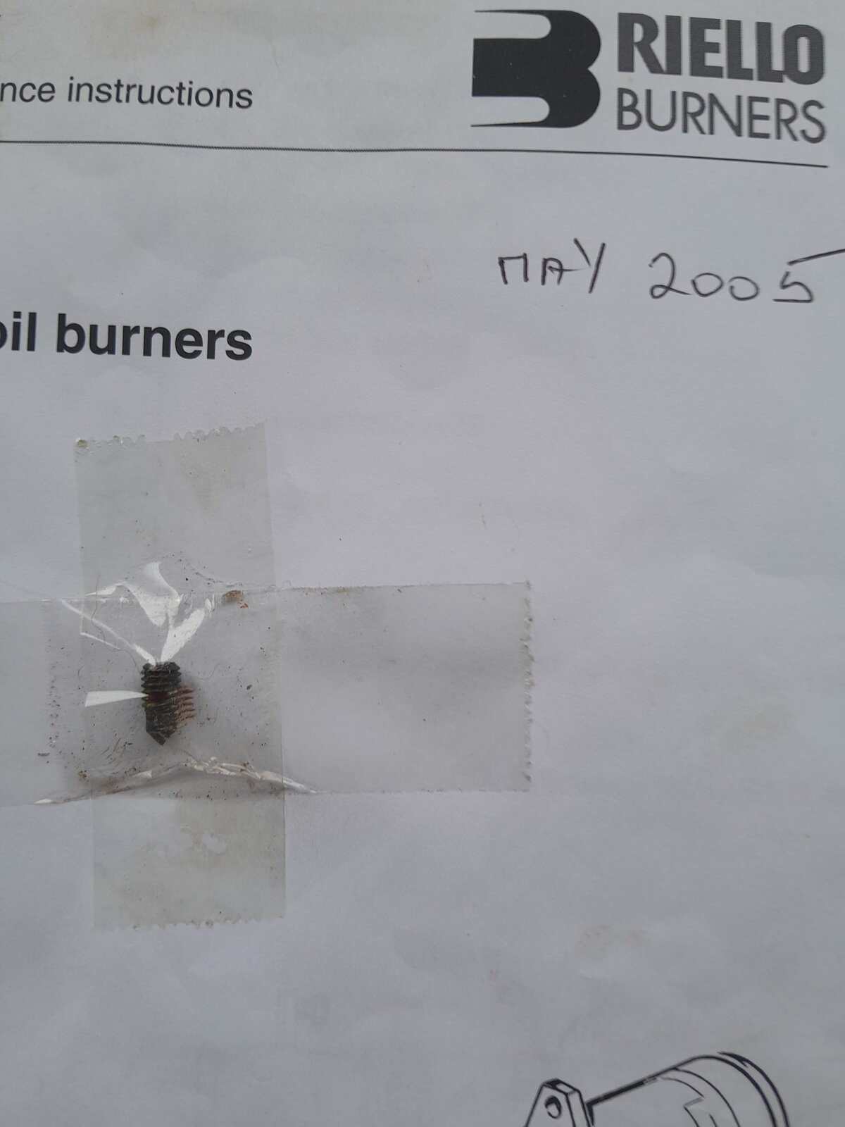

Not sure when using a Tiger Loop or similar but the Bypass blanking screw is removed if using a single pipe system and in place with a two pipe system where the second pipe recirculates the oil back to the tank, My 20 year old Riello G5X came with its screw taped to the front of the instruction manual, where it remains today.
